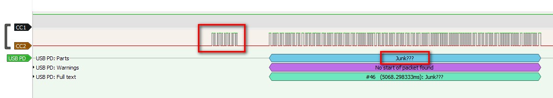

A. Attached are CC2 captured logs for 3 cases:
  1. Success Mini PC powering. Scenario: board is up but the Mini PC doesn’t get 20V. After that the USB C is re-connected and Mini PC is successfully powered (Reconnect success.sr)
  2. Success Mini PC powering after board power-up (Powerup success.sr)
  3. Mini PC powering fail after board power-up (Powerup fail.sr)
https://1drv.ms/f/s!AnBsc_2bz7JBg4MwUarXi-0Wvy2Jwg
It seems that there is some kind of "noise" that make the packets unreadable (it exist also in power-up fail case - Powerup fail.sr)

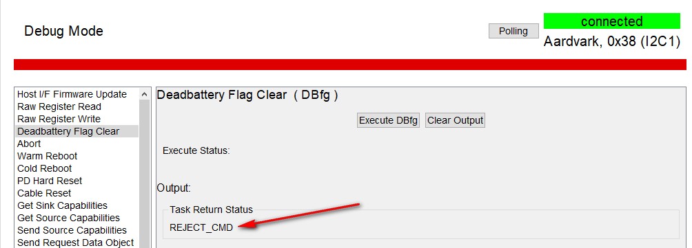

B. We try to remove 3.3V and re-apply it using the PS Enable pin for case when card is powered but doesn't supply 20V to Mini PC. It doesn't help. 20V doesn't rise.
