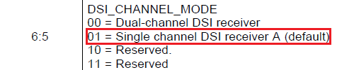

    3. You can write to register 0x10h bit[6:5] to switch between dual-channel or single channel DSI

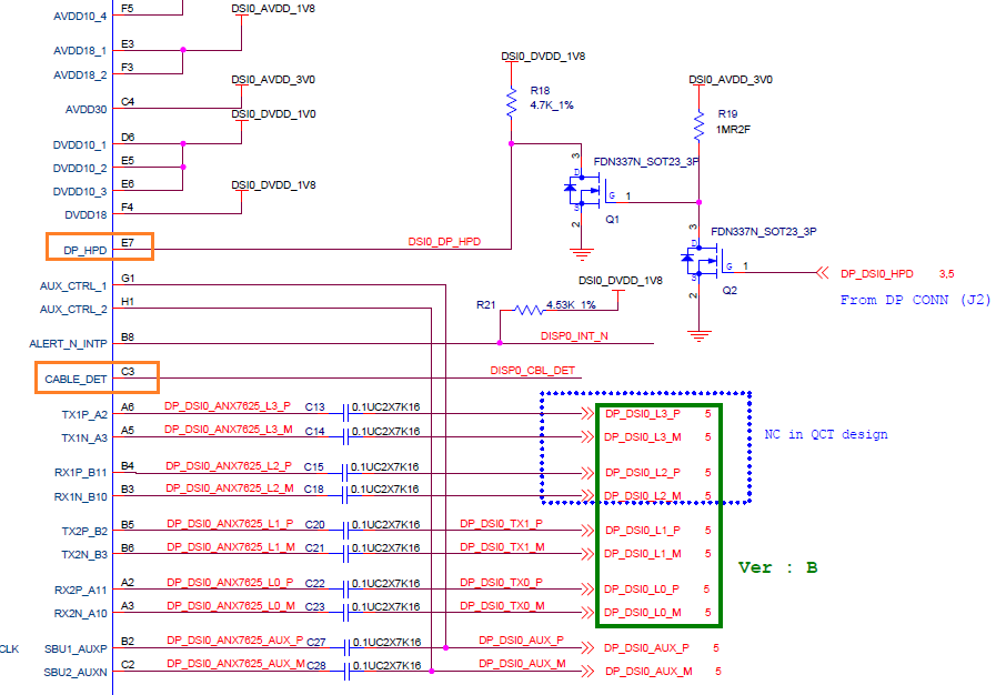

  • Hi David,
    2. We originally used Analogix's ANX7625 & it has a cable detect pin. Does SN65DSI86 need it?
    4. Does this IC have a frequency deviation specification of high & low temperature? (ppm)

    I can't find the ANX7625 datasheet to look at cable detect function, is it the same as HPD (hot plug detect)?
    =>Function is similar but it also has HPD.
    Can we use DSI B output alone by setting register 0x10h? Datasheet default only DSI A.

    DSI86 only has HPD, it does not have a CABLE_DETECT function.
    For single channel, only A will be used, you can't use channel B.
