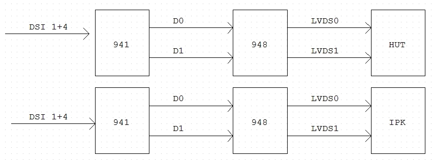

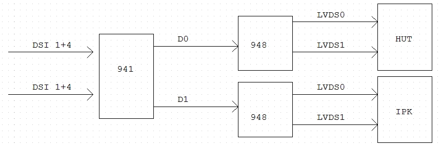

My customer wants to use SOC to output dual DSI signal (1+4 ),one is for Head Unit Display, the other is for Cluster. The resolution of both displays is 1920x720x60fps, and the range of PCLK is within 96Mhz. The application is just like the following picture.

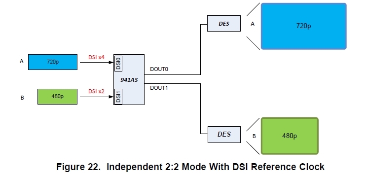

In 941's datasheet, single FPD-Link Ⅲ channel can support up to 105Mhz PCLK. And single FPD-Link Ⅲ  channel of 948 can support up to 96Mhz PCLK.
In this case, can we use one 941+ two 948 to achieve the above functions ?Or do I need two 941+two 948? Which solution should we use between the following:
