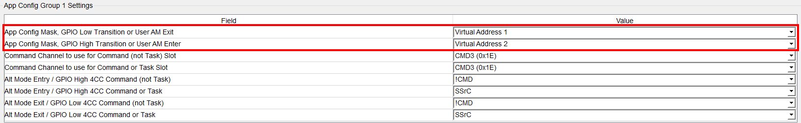

    Do you refer GPIO Low transition goes "Virtual Address 2" is expected behavior when the following is set?
    I think it can cause confusion because I understand GPIO low transition equals "Virtual Address 1" when the following is set.
    Yaita

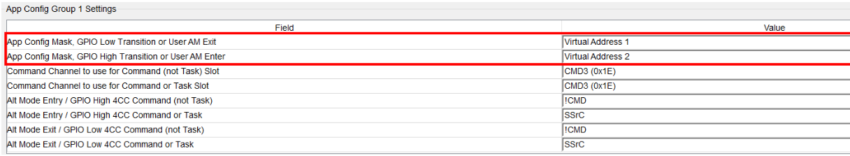

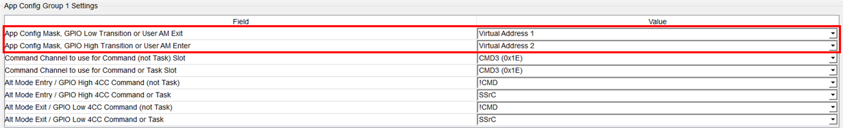

  • Hello Yaita,
    Apologize if my description was confusing. I am saying that with the configuration that you shared with me, the results highlighted below make sense as that is how the configuration is set.
    GPIO5 High to Low: VBUS= 15V
    GPIO5 Low to High: VBUS= 5V
    If you would like to have the results shown below, then you will need to change the configuration to where App Config Mask GPIO Low Transition goes to Virtual Address 2 and App Config Mask GPIO High Transition goes to Virtual Address 1
    GPIO5 High to Low: VBUS= 5V
    GPIO5 Low to High: VBUS= 15V
