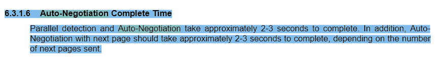

Hi Experts,
Is there any mechanism why auto negotiation compete time is long?
I am using 40cm length Ethernet cable and it seems to take about 500ms to complete Auto-negotiation. What kind of factors affect this time to become long like 2 - 3 seconds?
Uchikoshi
  • Hi Uchikoshi-san,
    Auto-negotiation process involves two PHYs advertising their capabilities to each other and then linking up with best configuration that is supported by both PHYs. Ethernet PHYs are supposed to keep advertising their capabilities at periodic intervals until a link is successfully established. This process is defined in IEEE standards and involves multipe timers that decided how long to wait for link to be up before auto-negotiation is started again. These timers can add up to several hundreds of milliseconds. Sometimes, the link is not established in the first attempt and multiple autonegotiation attempts are required for link up. In such cases, the link up time can become 2-3 seconds.
    -Regards
    Aniruddha
  • Hi Aniruddha,
    Thank you for your detail explanation.
    Do you have any information about the conditions which takes such 2 - 3 seconds?
    Uchikoshi
  • Hi Uchikoshi-san,
    It can be due to different factors like timing mismatch between transmit of one PHY and receive of another PHY or some FLPs not being detected by one PHY. It is difficult to list all factors that can affect the link up time.
    -Regards
    Aniruddha
