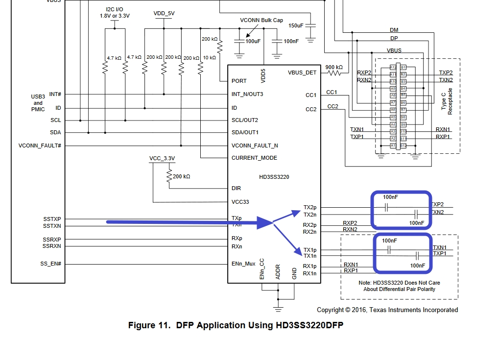

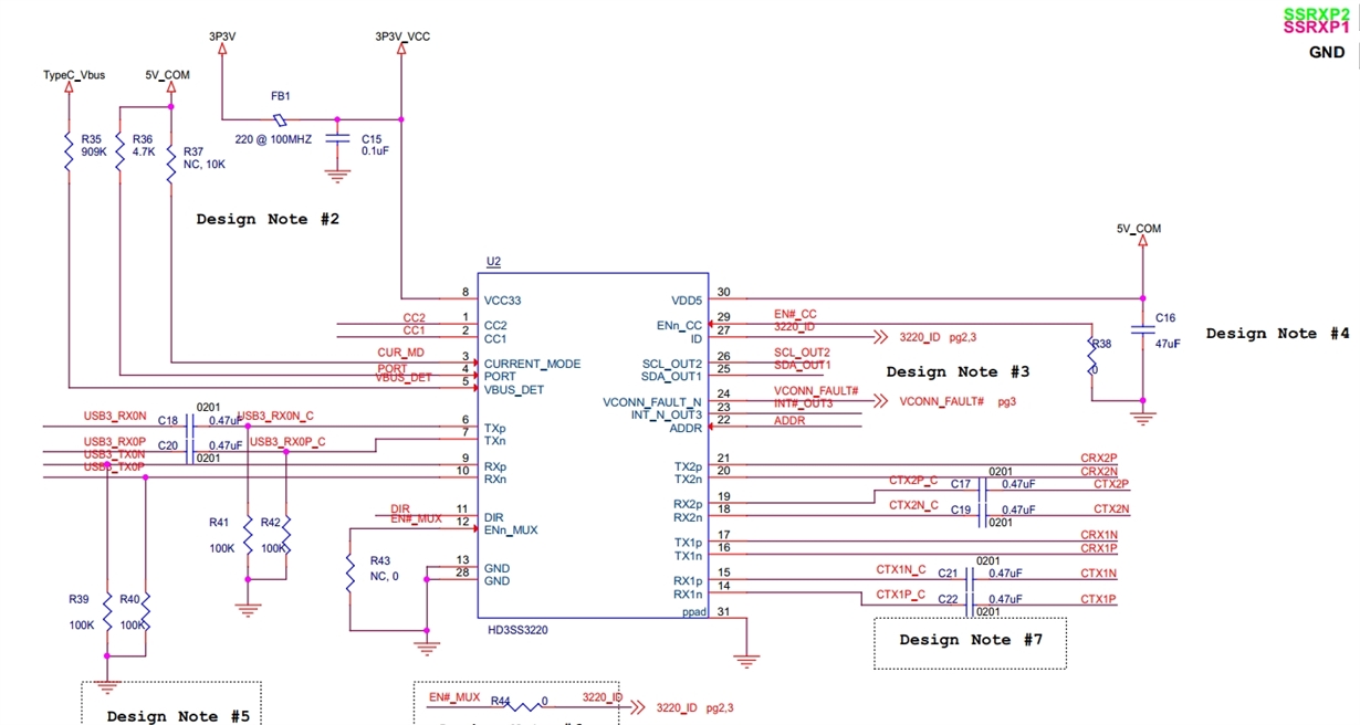

I received a question about capacitors on Tx/Rx.
Is it ok to remove the capacitors on Tx2p/Tx2n, Rx2p/Rx2n, and Tx1p/Tx1n and then is it ok to place the capacitor on Txp/Txn side?  Please refer to the following link.
