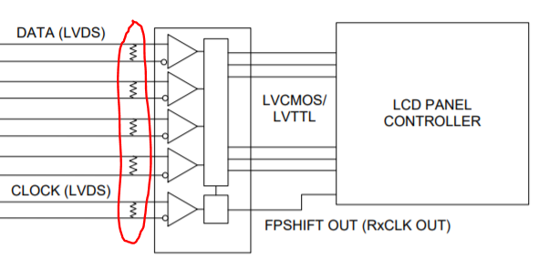

There is no image on display. Input signals tested and they are proper. But ground plane (for LVDS GND, PLL GND and GND) is common. I think these ground plane should be separate.
Input for DS90CF384A is connected with shielded LVDS cable. Output is connected to RGB interface display. This IC is assembled on separate PCB.
Input LVDS signals pair connected to respective RxIN pins. Input LVDS CLK input are connected to RxCLKIN pins. These LVDS signals are coming from PC motherboard.
Output RGB signals are connected with reference to datasheet (Figure 4. “16 Grayscale” Test Pattern (DS90CF384A)).

I have checked the mapping between motherboard and the DS90CF384A.
It is similar to Figure 10 of datasheet. Please see attachment.

Hi Sandeep,
In addition, I just noticed that you are not terminating the LVDS inputs in your schematic. The DS90CF384A requires 100 ohm differential termination resistors on the LVDS data lanes and LVDS clock lane, as close to the device inputs as possible:
Please add these resistors and check if the problem still persists.
