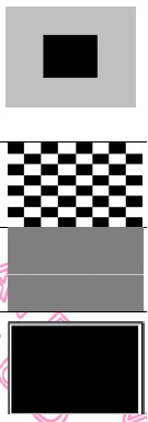

Our PCBA used DS90UB928, but those PCBA system were without FPD-LinkIII and without DS90UB927.
We want to enter the BIST mode (using 928 Internal pattern generator) to light the LCD-panel.
We had tried as below, but still fail to light panels by BIST-mode.
We had tried:
4. Set register address 0x39 as value of 0x02(1: Pattern Generator with internal PCLK)
5. Set register address 0x64 as value of 0x61 (1: Enable Pattern Generator)
Hope for your suggestion.
Thanks.
Sauron Huang
Hello Sauron,
BIST mode and PATGEN are two separate mechanisms, not related. These two modes should not be enabled at the same time. For PATGEN, please reference this app note for configuration.
http://www.ti.com/lit/an/snla132c/snla132c.pdf
Casey
