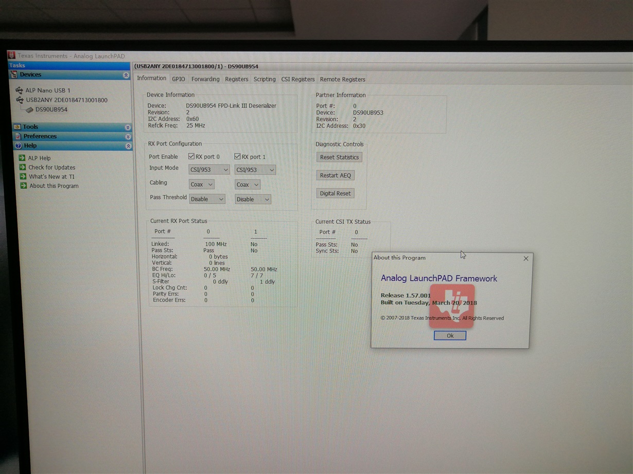

Dear Sir,
It is very strange , margin analysis Tab cannot be found when ALP is connected with UB954 on some PC.  Does anybody give me some advice?
  • Hello Tiger,
    Thanks for sharing screen shot. You have the correct ALP Framework (v1.57.0010 ) released Mar 20, 2018. After this we made a number of updates (including Margin Analysis support) and these are released as ALP-PROFILE-UPDATE in our website.
    TI provides through "ALP-PROFILE-UPDATE" new profiles and scripts to add to the latest version of the ALP framework utility without complete uninstall and reinstall.  Quit ALP if it is running and as shown in the screen shot below, please go to and download and install the latest ALP-PROFILE-UPDATE.  Then restart ALP. You should see Margin Analysis Tab.
    http://www.ti.com/tool/ALP
    Let us know any issues.
