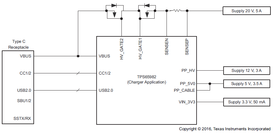

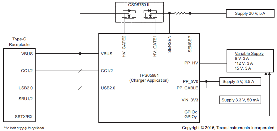

Hi Sirs,
Sorry to bother you.
May i know which pin of TPS65981 can be configured the function likes PP_HVEXT_EN in TPS65982?
I looked for the attached spec.
In pin table, you can see GPIO1(PP_HVEXT_EN) information.
