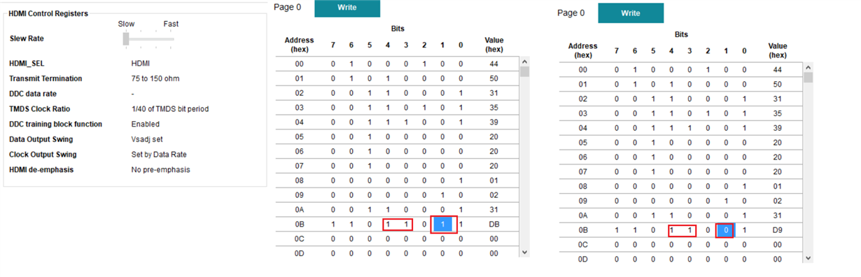

Our customer is used the AMD platform. But Through DP159EVM cant run the 4k 60Hz(4K 30Hz is OK).
We have change monitor & cable not improve. Do you have any idea or any experience?

Register dump shows at 4k@60Hz, they need to change the TX_TERM_CTL (Register 0x0Bh, bit [4:3]) needs to be set to 0x11. Bit 1 of register 0x0Bh also needs to be set to 1 base on the DDC snoop.
When they change from 4k@30Hz to 4k@60Hz, do they toggle HDP_SNK?
David
Hugo
4k@30Hz is HDMI1.4 and 4k@60Hz is HDMI2.0.
For HDMI1.4, TMDS_CLOCK_RATIO_STATUS bit needs to be set to 'b0, and for HDMI2.0, TMDS_CLOCK_RATIO_STATUS bit needs to be set to 'b1.
The TMDS_CLOCK_RATIO_STATUS bit can be set automatically by snooping the DDC bus, or can be set manually, but DDC_TRAINING must be disabled first.
Are they changing from HDM1.4 to HDMI2.0 on the fly? If they do, do they toggle HPD_SNK when they change from HDMI1.4 to HDMI2.0? If they do not toggle HPD_SNK, are they toggle PD_EN when changing from HDMI1.4 to HDMI2.0?
Please dump out both Page 0 and Page 1 register one more time after you make the change.
