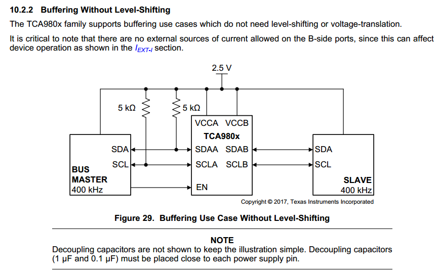

I want to implement an I2C signal buffer to drive my I2C LCD.
The reason is that without the buffer, the DSP 28020 GPIO is not powerful to drive it.
You can see the waveform below. Rise time is not decent.
Code is successfully generated. 0x7C(slave address), 0x80, 0x28 are sent with a stop on the DATA wire.
After I add the I2C signal buffer chip, LCD is not properly initialized.
Because the waveform now looks like this (probe on TCA9803 output)
DSP is only able to send the first byte, 0x7C, the rest 2 bytes are missing and no stop condition is generated.
The buffer chip I use is TCA9803 from TI, and the circuit schematic is here.
I use 3.3V here. EN is directly connected to 3.3V.
Q1: I guess it is a hardware problem. Can anyone help me with this?
Q2: If I choose to drive my LCD by DSP directly, what is the right schematic? Do I connect SDA and SCL to LCD port without other component? or I need to add two pull up resistors for SDA and SCL wire?

    I agree it looks like a hardware issue which seems to begin with the ACK bit of the first transaction, so let me first make sure I understand your set-up.  Does your schematic exactly match the datasheet screenshot above (except with VCC = 3.3 V)?  And, is the DSP acting as "master" on the A side and the LCD as "slave" on the B side?  Are there any pull-up resistances on the B side (for example, ones integrated into the LCD)?  Is the DSP configured for "open drain" type outputs (i.e., the low level is strongly driven but the high level is high impedance) or is it configured for "push pull"?
    Where are the waveforms being measured - on the DSP side or the LCD side?
    To answer your other question about the direct connection - I2C uses open-drain signaling in order to achieve bidirectional communication, and so generally pull-up resistances are required.

    Q: Does your schematic exactly match the datasheet screenshot above (except with VCC = 3.3 V)? A: VCC is 3.3V, EN is directly connected to 3.3V, all the other parts are exactly matched.
    Q: Is the DSP acting as "master" on the A side and the LCD as "slave" on the B side? A: yes.
    Q: Are there any pull-up resistances on the B side (for example, ones integrated into the LCD)? A: I don't know. I attach a datasheet of the LCD for your reference.LCD Datasheet.pdf
    Q: Is the DSP configured for "open drain" type outputs? A: DSP GPIO is configured internal pull up resistor enable.
    Q: Where are the waveforms being measured - on the DSP side or the LCD side? A: LCD side. TCA9803/LCD side.

    I find the hardware reason of rise time issue. Now I remove the capacitors on the I2C bus wire and now the rise time looks good(DSP drives LCD directly, TCA9803 is not used).
    I also tried disable internal pull up and added 2 3.6kohm external pull up resistors(I did not find a 5.1kohm). The rise time is even better(DSP drives LCD directly, TCA9803 is not used).
    For the TCA9803, it is not easy to reach master/buffer interface so I am not able to provide you a screenshot.
