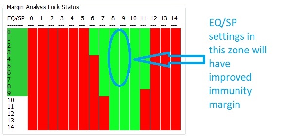

    I'm working on the app note now.  Here is the AEQ optimization content I have so far:
    ---Use the ALP Margin Analysis tool to determine acceptable AEQ/SP settings.
    ---Set AEQ/sFILTER min/max limits to allow only setting near the center of the “eye”.
    Margin analysis user guide is here.
    Mike
    951_958_EMC_102255-5_Final.pdf
  • Looks like an image dropped from my last response.  Here it is:
  • Hi Mike,
    I have already measured the EQ/SP settings in the past and they were looking good(many green blocks, no issue here).
    I will look into the lock settings as well.
