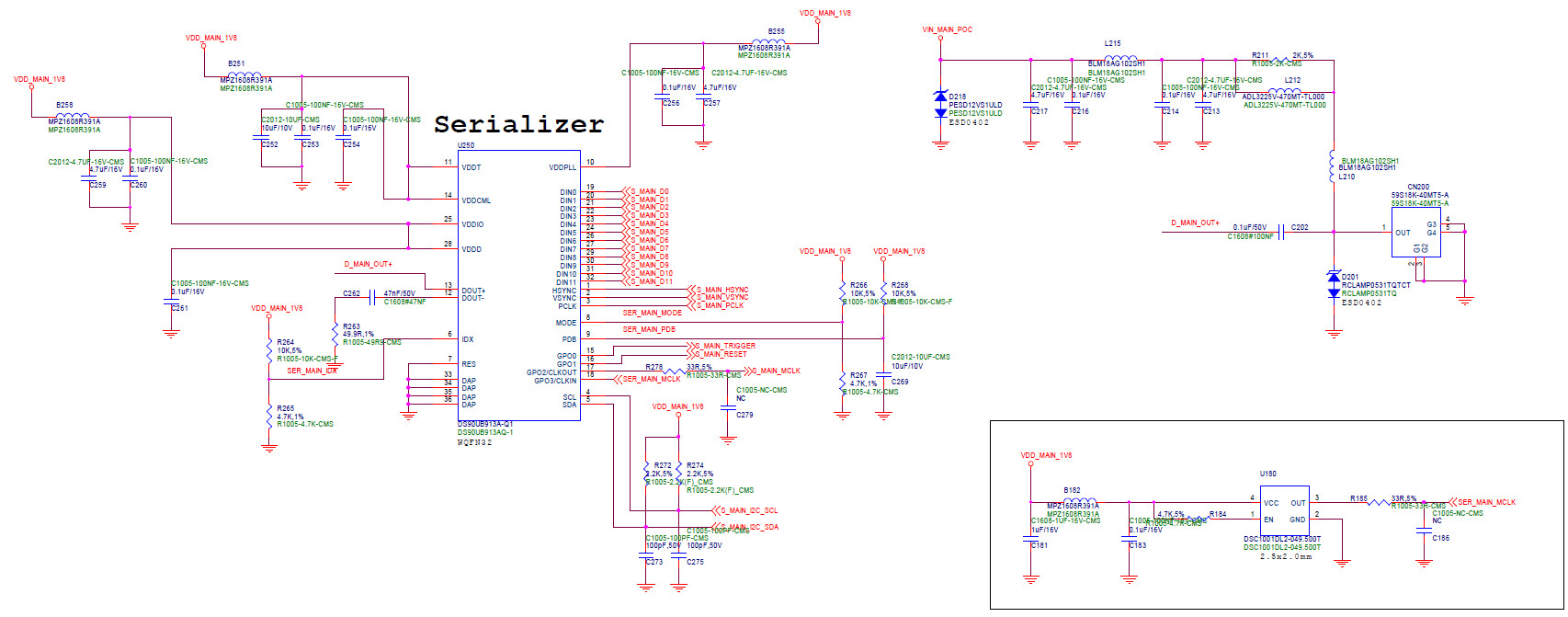

Hello Sirs,

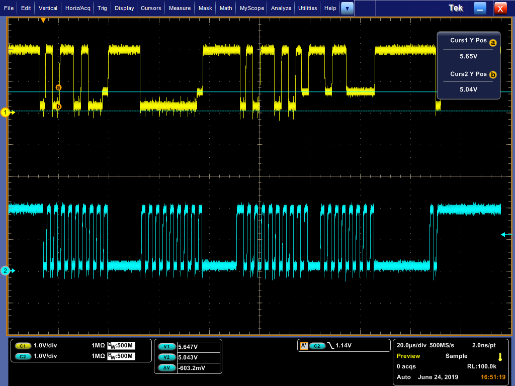

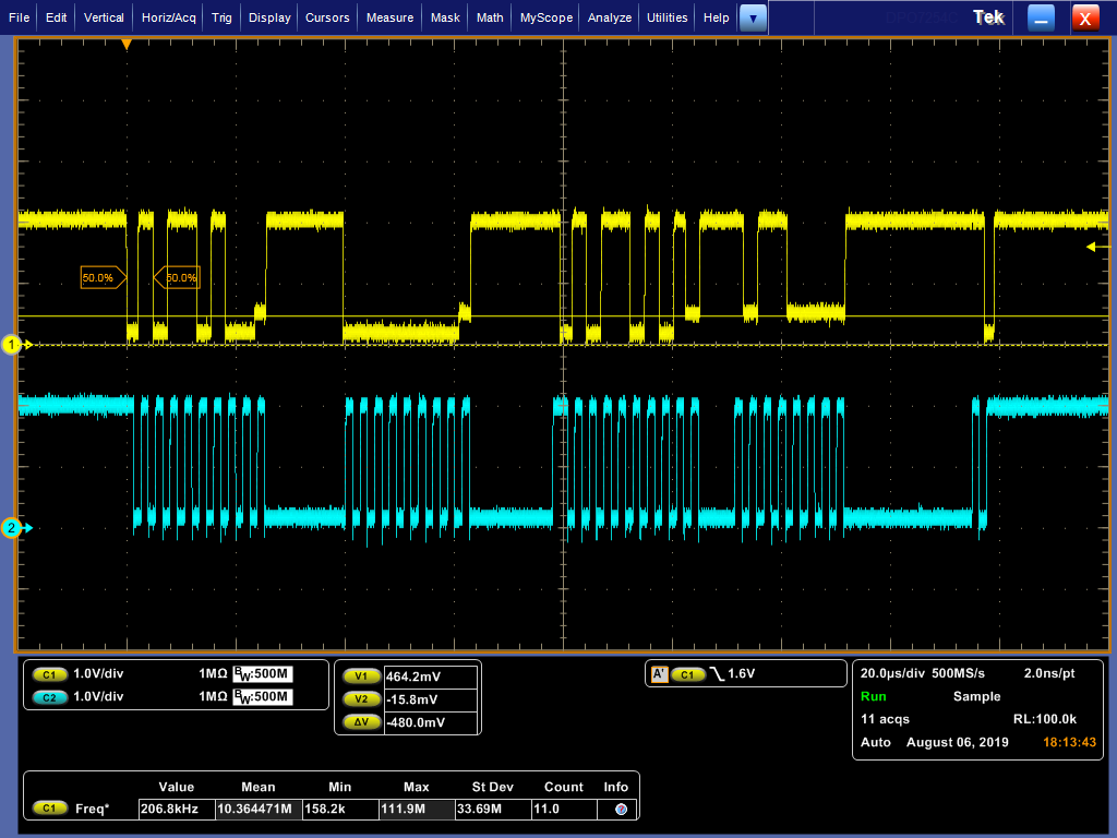

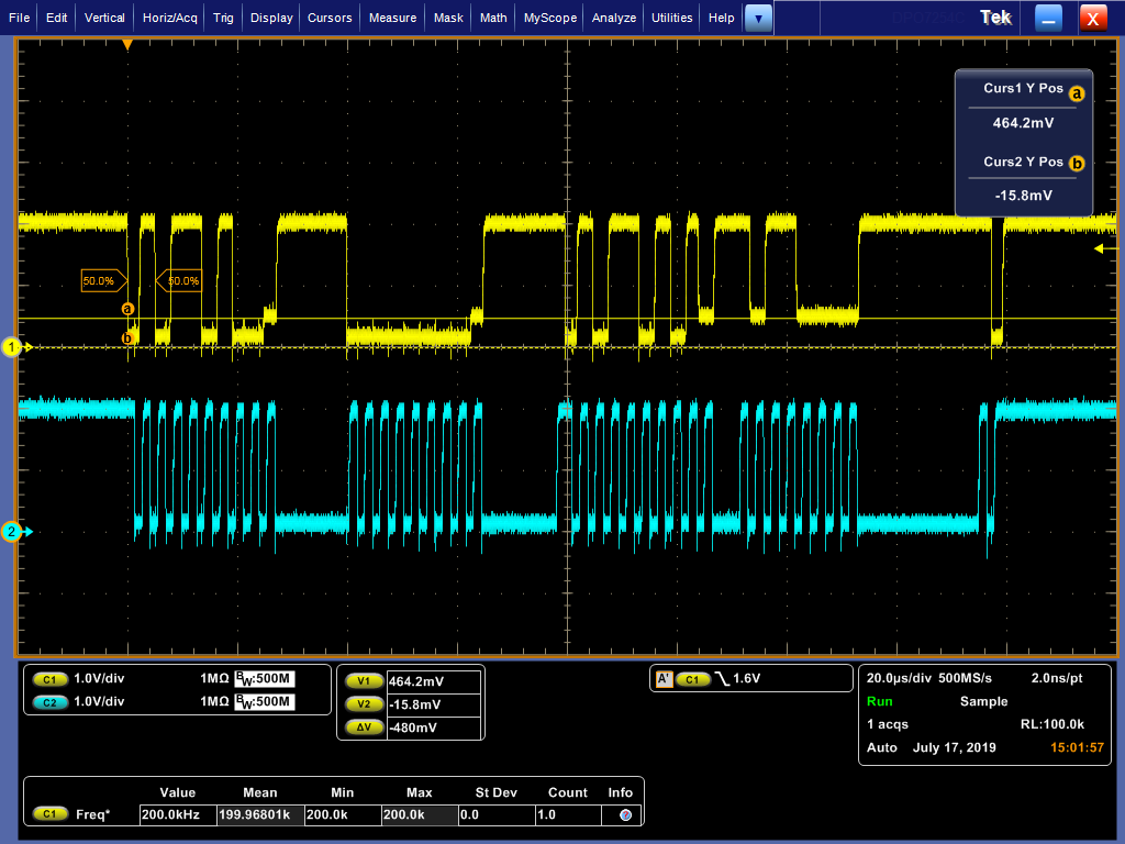

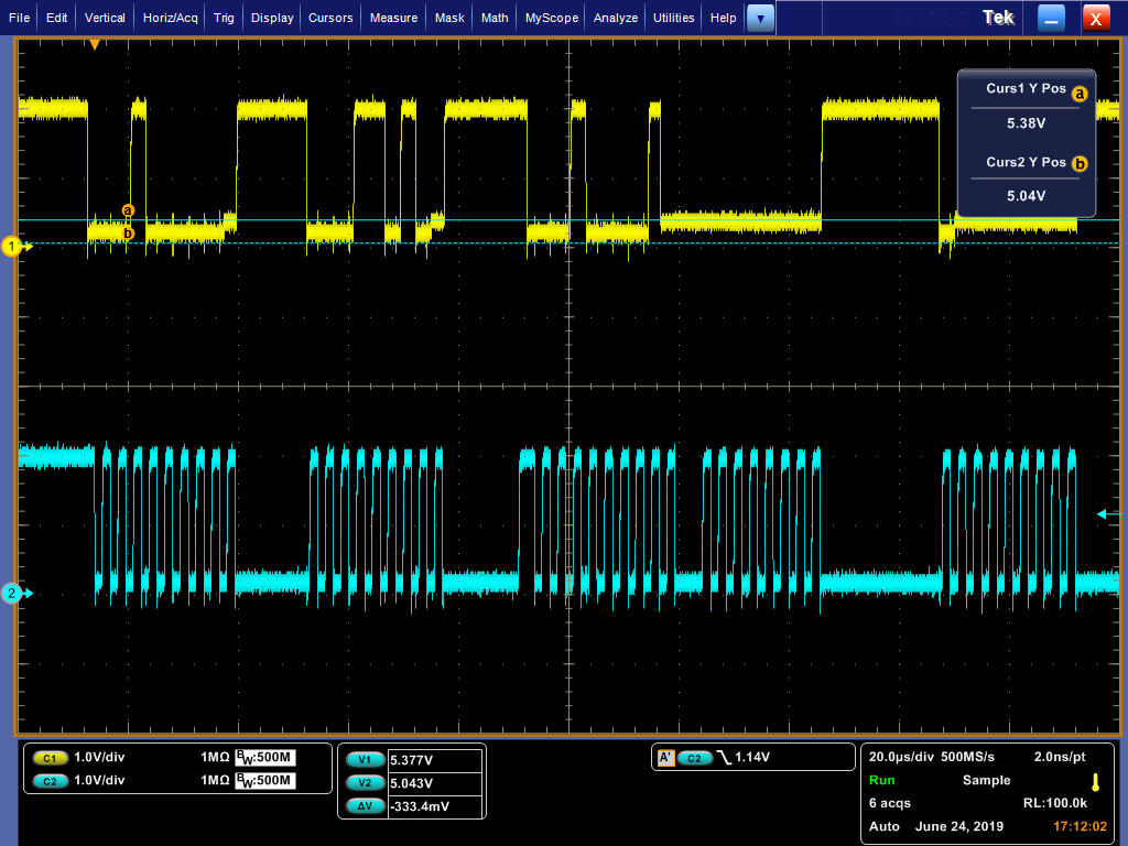

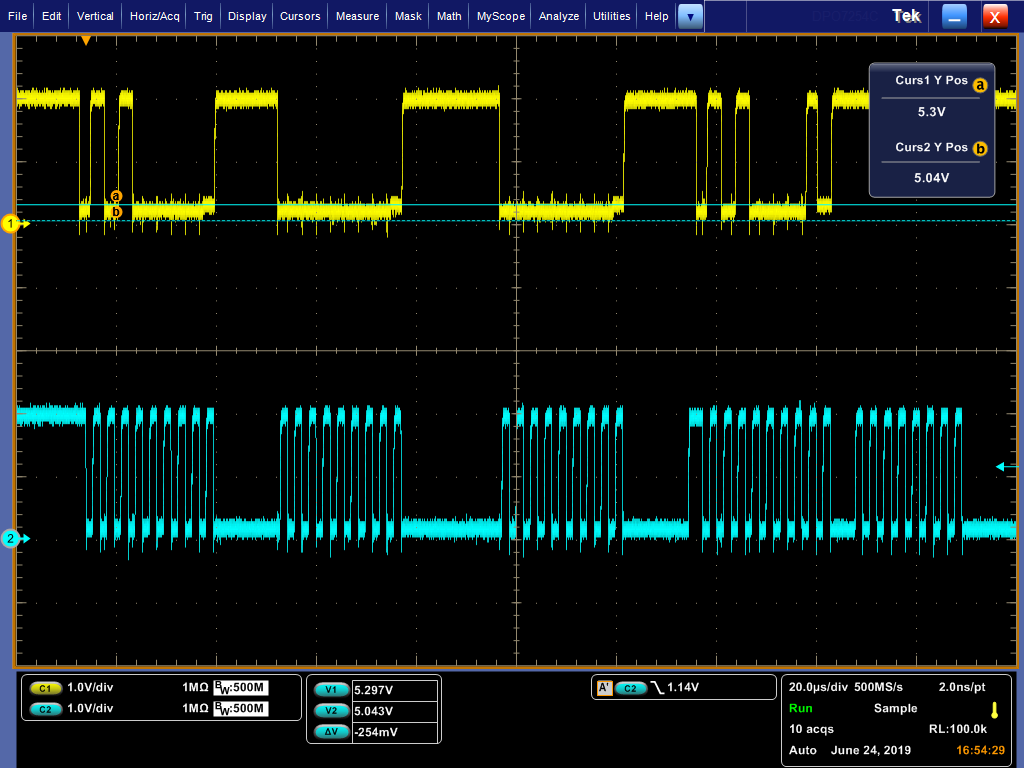

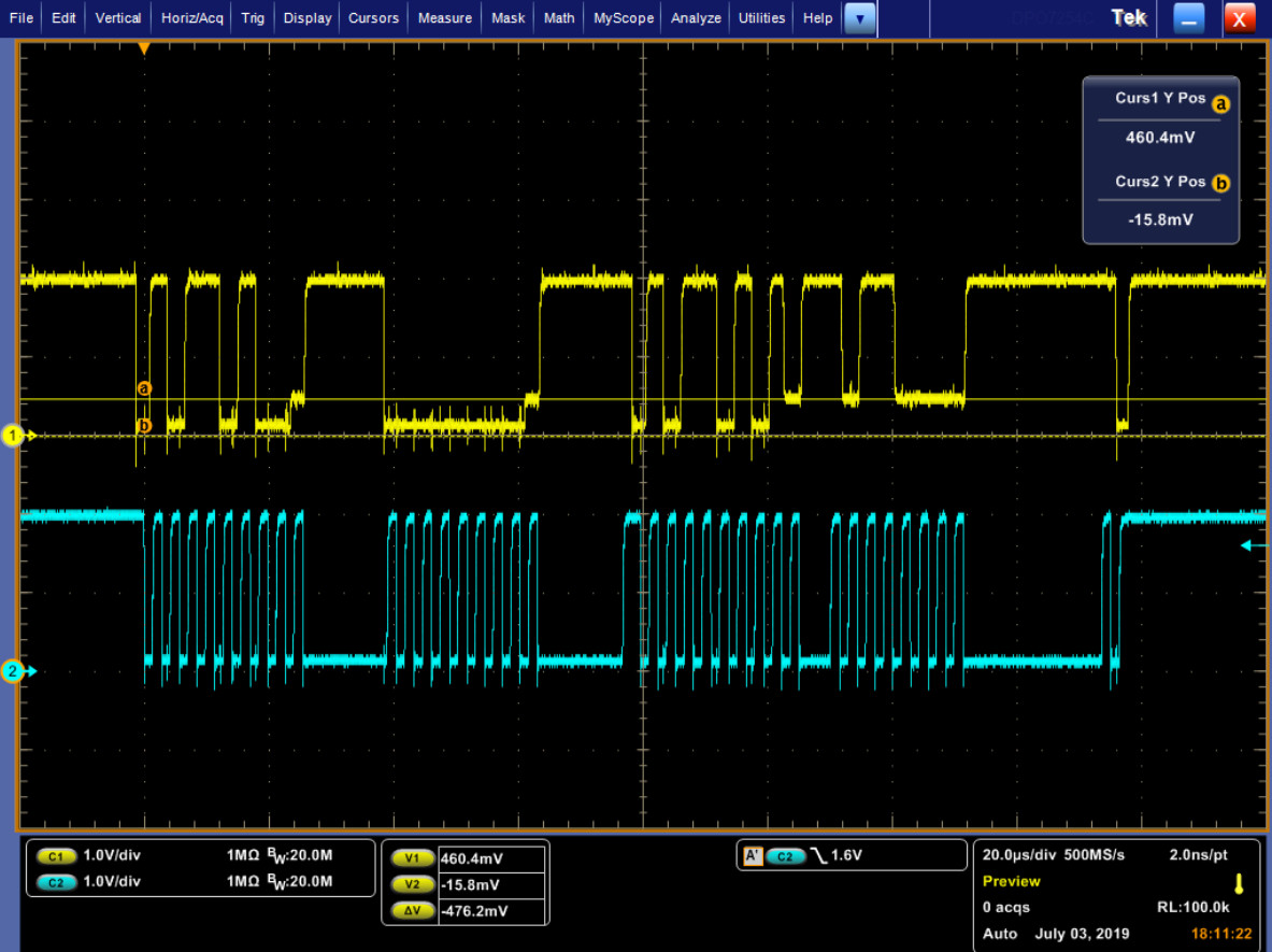

DS90UB913A D/S show  Vol spec is below 0.36V at 1.8Vddio & 2.2K ohm pull up.
But we see the waveform is around 0.6V . So far function is no problem but worry this potential risk .
Would you pls help to comment ?  TKS !
