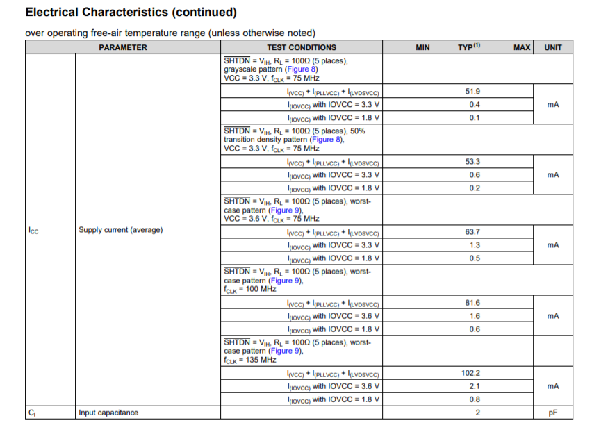

For the ICC, our data sheet only have the TYP value, so we are wondering if there have a way to know or estimate the MAX value? Thanks

Unfortunately we do not have a way to estimate at this time since the device is quite old. It would likely take a re-char for us to find this type of info. As you can see it also varies quite a bit based on the mode.
