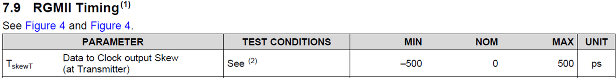

TskewT for transmitting of RX signals
Part Number: DP83867IR
 I want to know that the specification of RX timing at the Shift mode. Because, I need to adjust RGMII RX transmit timing with TskewT in PHY device.
My questions are:
1) Data sheet is described that TskewT is +- 500ps. Is this the value in align mode "RGMII_TX_CLK_DELAY = 0"?
2) When I select shift mode "RGMII_TX_CLK_DELAY = 1" and "RGMII_TX_DELAY_CTRL=0111b" ,  Is the timing spec that TskewT is type 2ns and MIN/MAX +-500ps?
