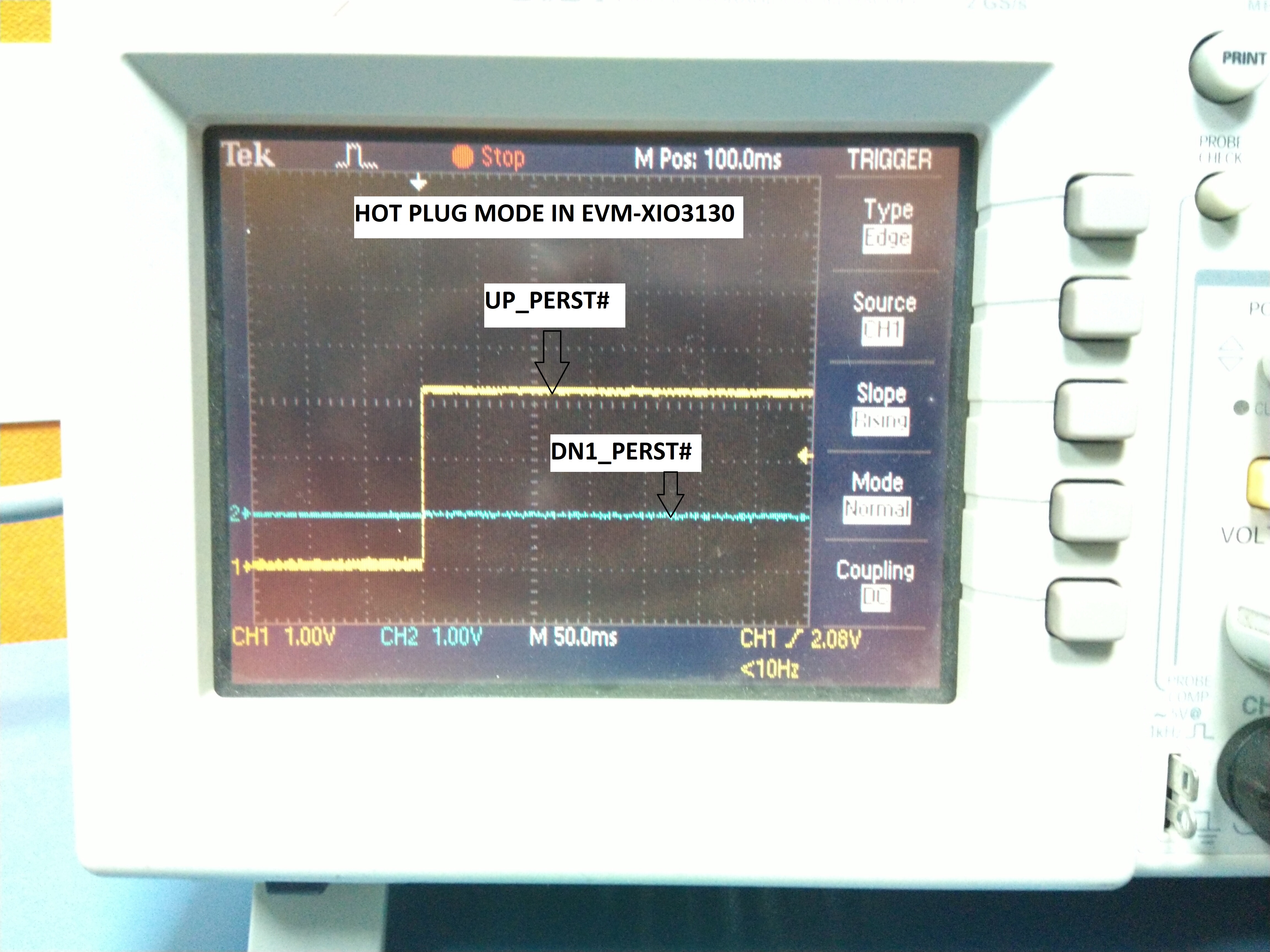

  • Hello I.K.,
    We understand that, To operate XIO3130 in Hot Plug Mode, there should be Hot Plug Controller in Design where as in our design we are not using any Hot Plug controller to control Power Supply for PCIE Port so we cannot operate our board in Hot Plug Mode.
    As per Errata Solution 2, Operate the XIO3130 in Hot Plug mode so we write the EEPROM for Hot Plug Mode in EVM-XIO3130 and make necessary Jumper and Switch setting as per SLLU108 (EVM User Guide) section 1.3.
    Result:- UP_PERST# change the State from Low to High after Power ON but DN1_PERST#, DN2_PERST#, DN3_PERST# stays in Low state through out and clock in not Generated from Down Stream Port.

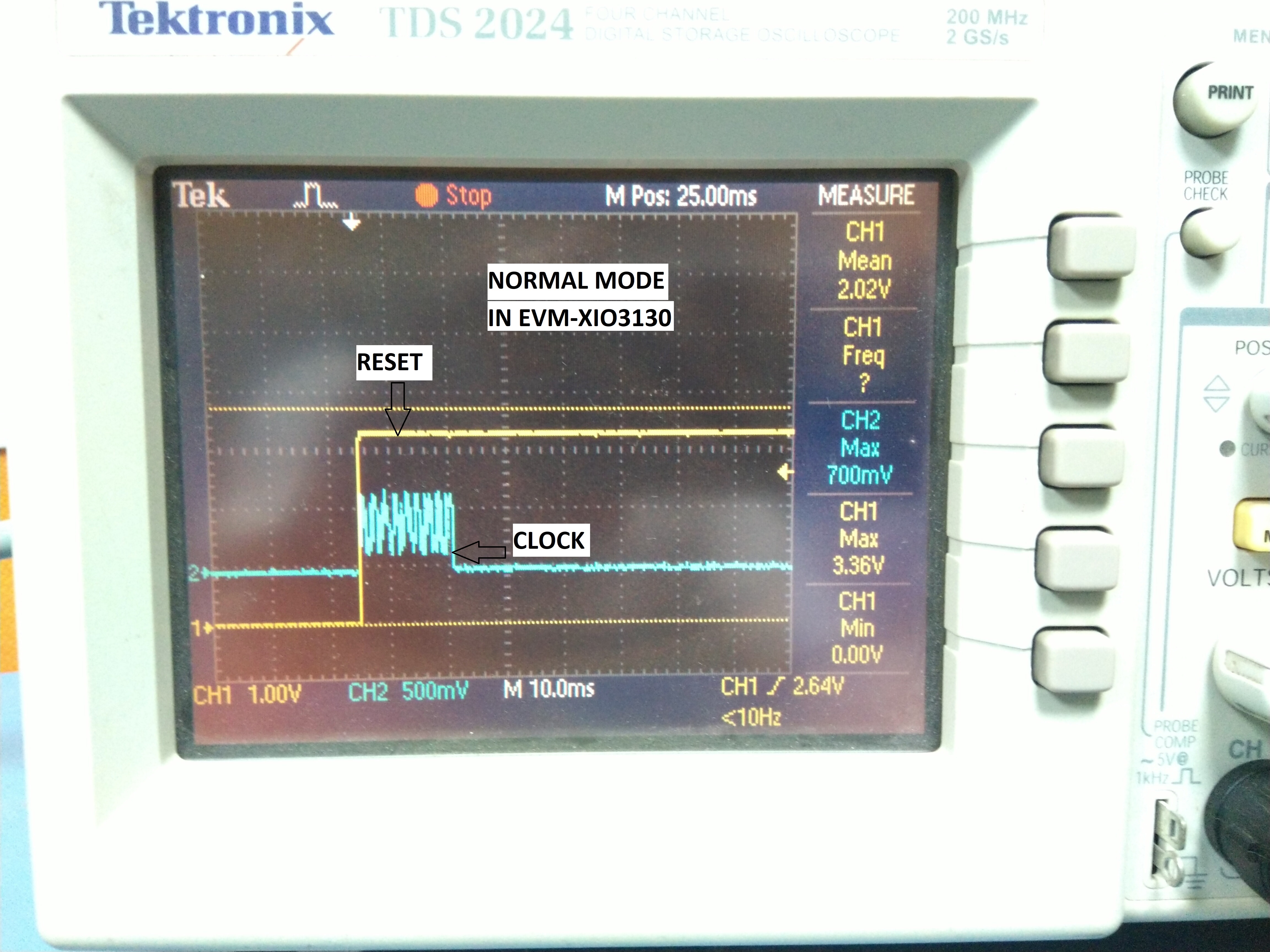

    We also write the EEPROM in Normal Mode in EVM-XIO3130 and make necessary Jumper and Switch setting as per SLLU108 (EVM User Guide) section 1.2.
    Result:- UP_PERST# change the state from Low to High after Power ON,  DN1_PERST#, DN2_PERST#, DN3_PERST# also change the state from Low to High and the clock is generated same time of PERST# but disable after 15ms. Please refer the attached Image.
    We also want to know, What is the requirement to generate the DN#_REFCKO and DN#_PERST#.
    Also find the EEPROM File for Normal Mode and Hot Plug Mode for our Design.
    Kindly provide your suggestion.
    Alpesh

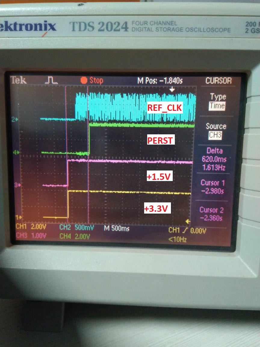

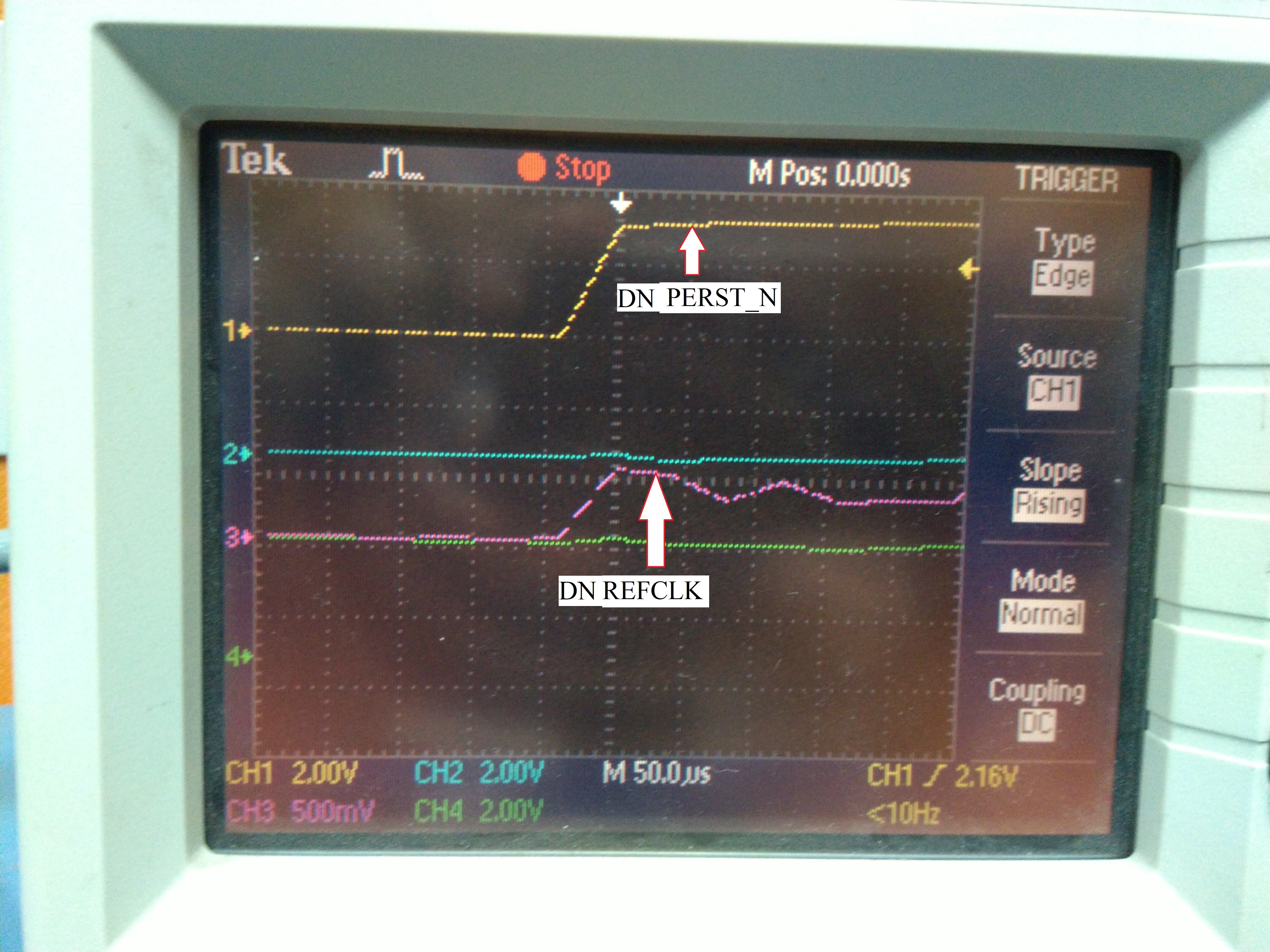

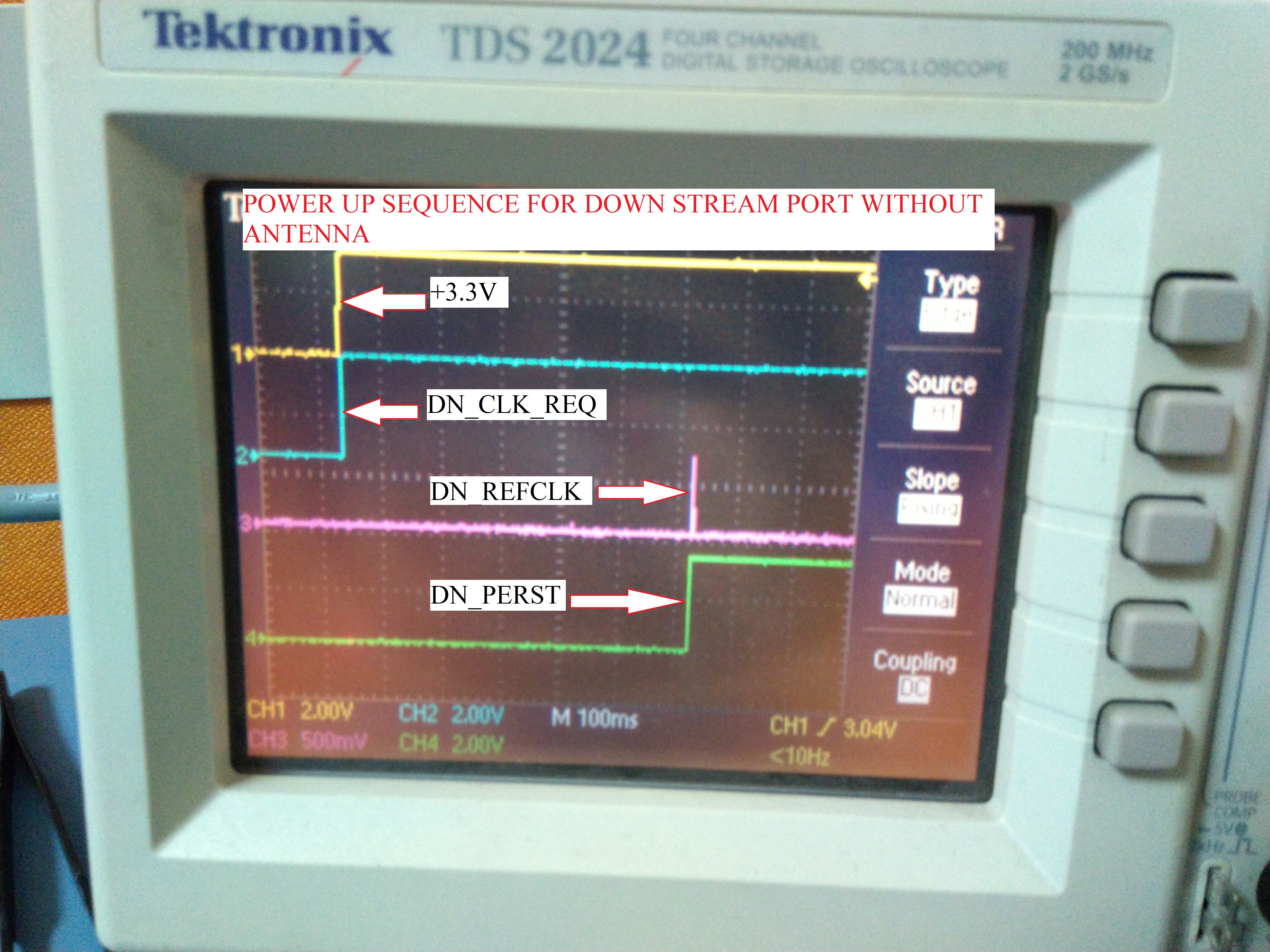

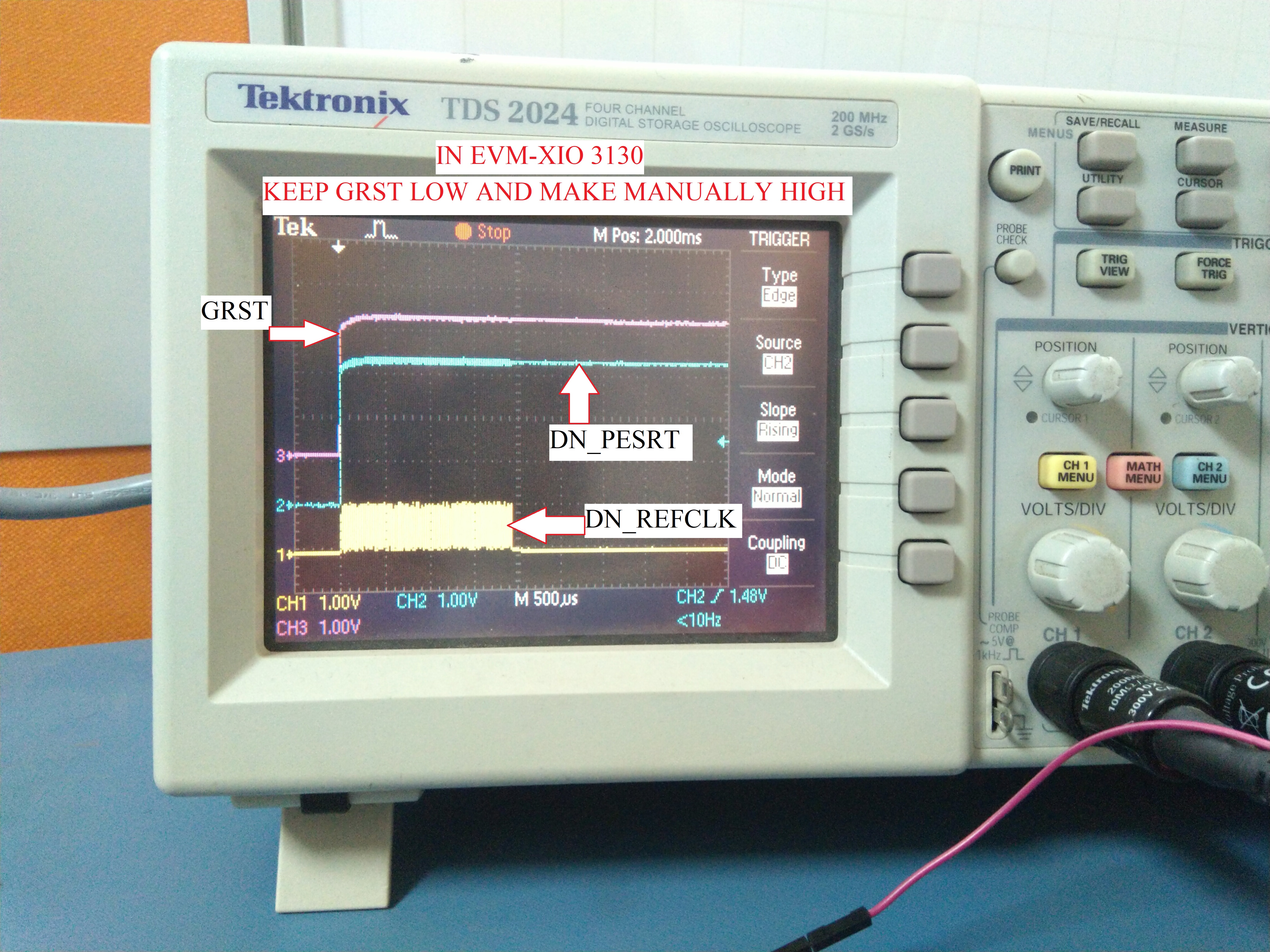

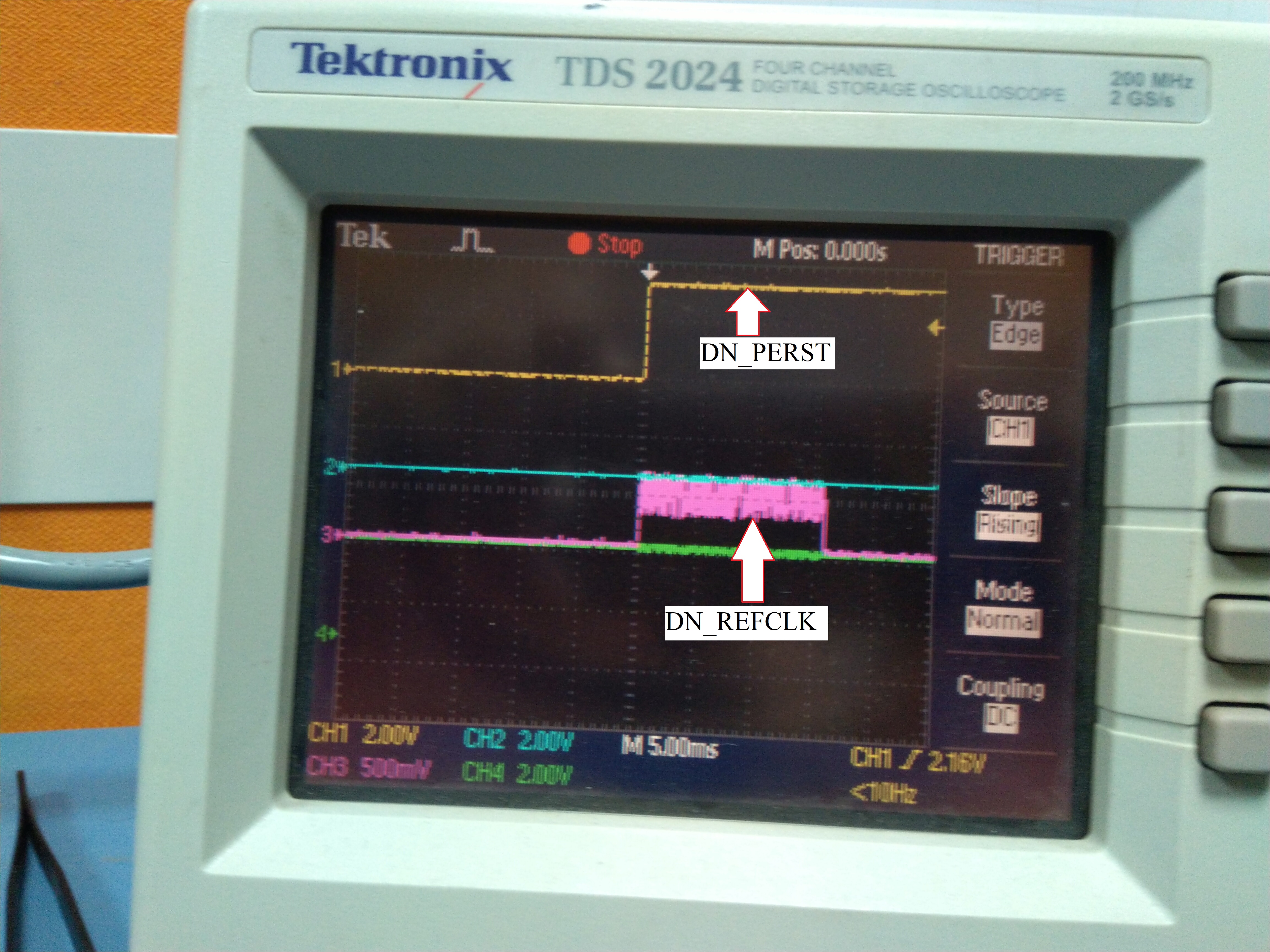

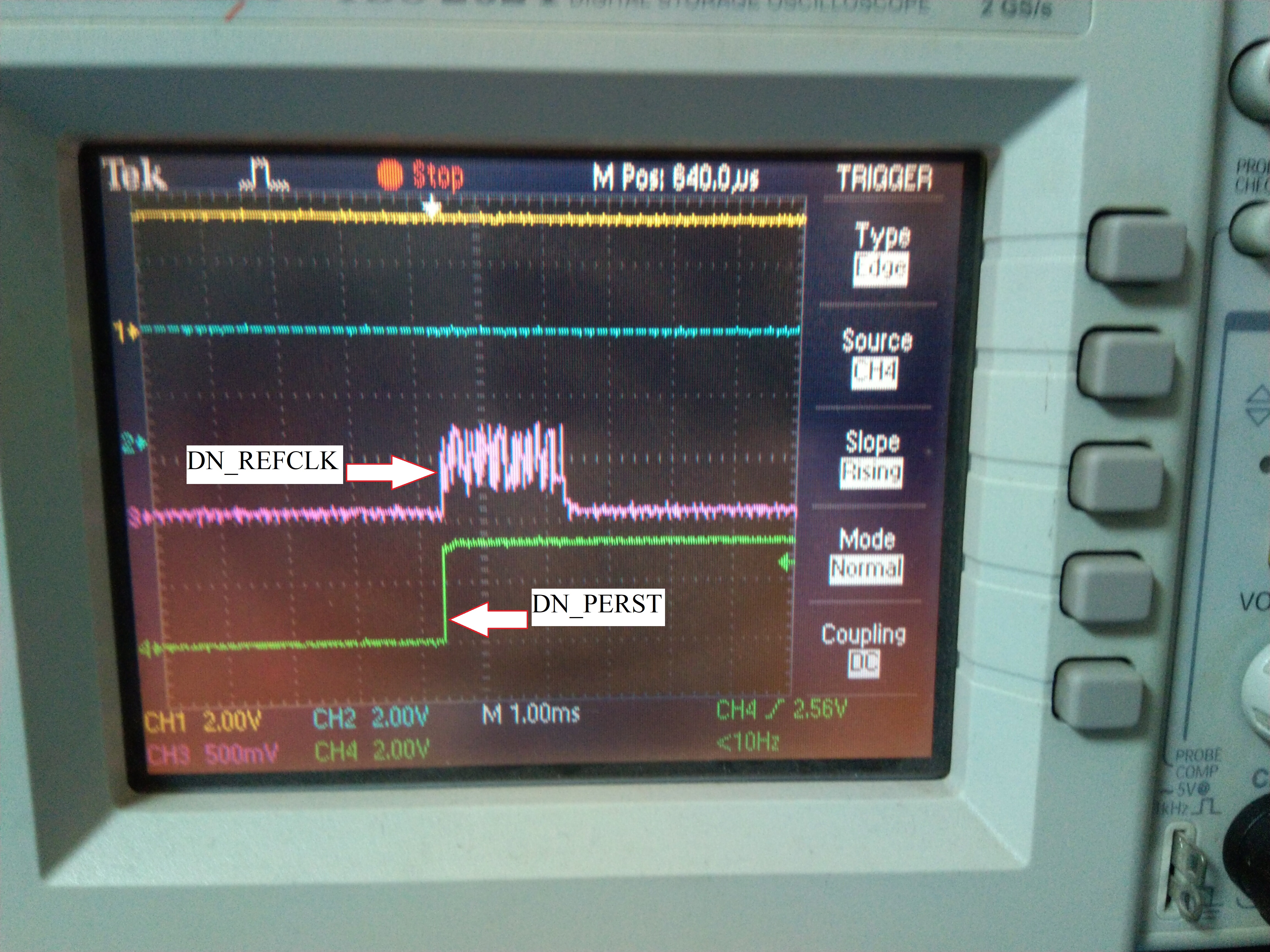

  • Hello I.K.,
    As per your suggestion, We have tried to keep the GRST LOW and make it high by Manually(In EVM XIO3130) but the clock is not Generated on Down Stream Port.
    We have check the Power Up Sequence for Down Port Signals.
    We have also connect the Antenna with our Board and check the Down Port Signals but the Clock is not generated.
    Please find below Images for your reference.
    Observation:-
    • Reference Clock for Down Stream Port is generated at the same time of DN_PERST only for 10ms and then Low.
    Query:-
    Ref Clock is going in to  Up_Stream Port in XIO3130, so my question is that:
    Is there any specific setting into XIO3130 to switch this Up Stream clock to particular Down Stream Port (Out of Three)?
    and If Yes, then How to make this setting Correct?
    If EEPROM is the Answer then we need that details.
    Alpesh

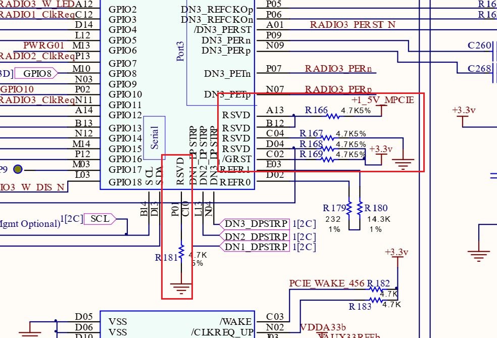

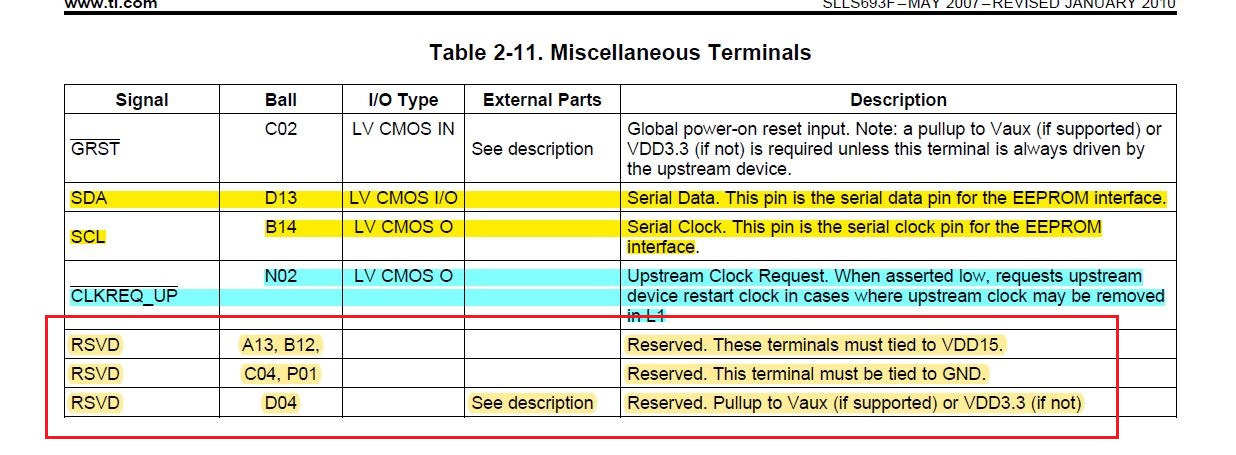

  • Hello I.K.,
    We have checked power-up sequence on upstream of the XIO3130 and it is as per Datasheet.
    Also verify the RSVD pins (A13, B12, C04, P01, D04) termination which are as per datasheet.
    Please find the below Images for your reference.

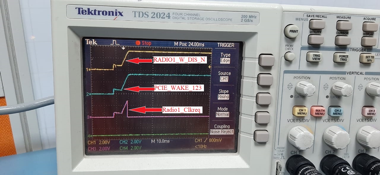

  • Hello I.K.,
    Thanks for the valuable Information.
    I cannot directly connected Antenna Board to my PC because PCIE Port connectors are not same in Antenna Board and PC.

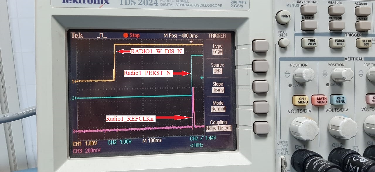

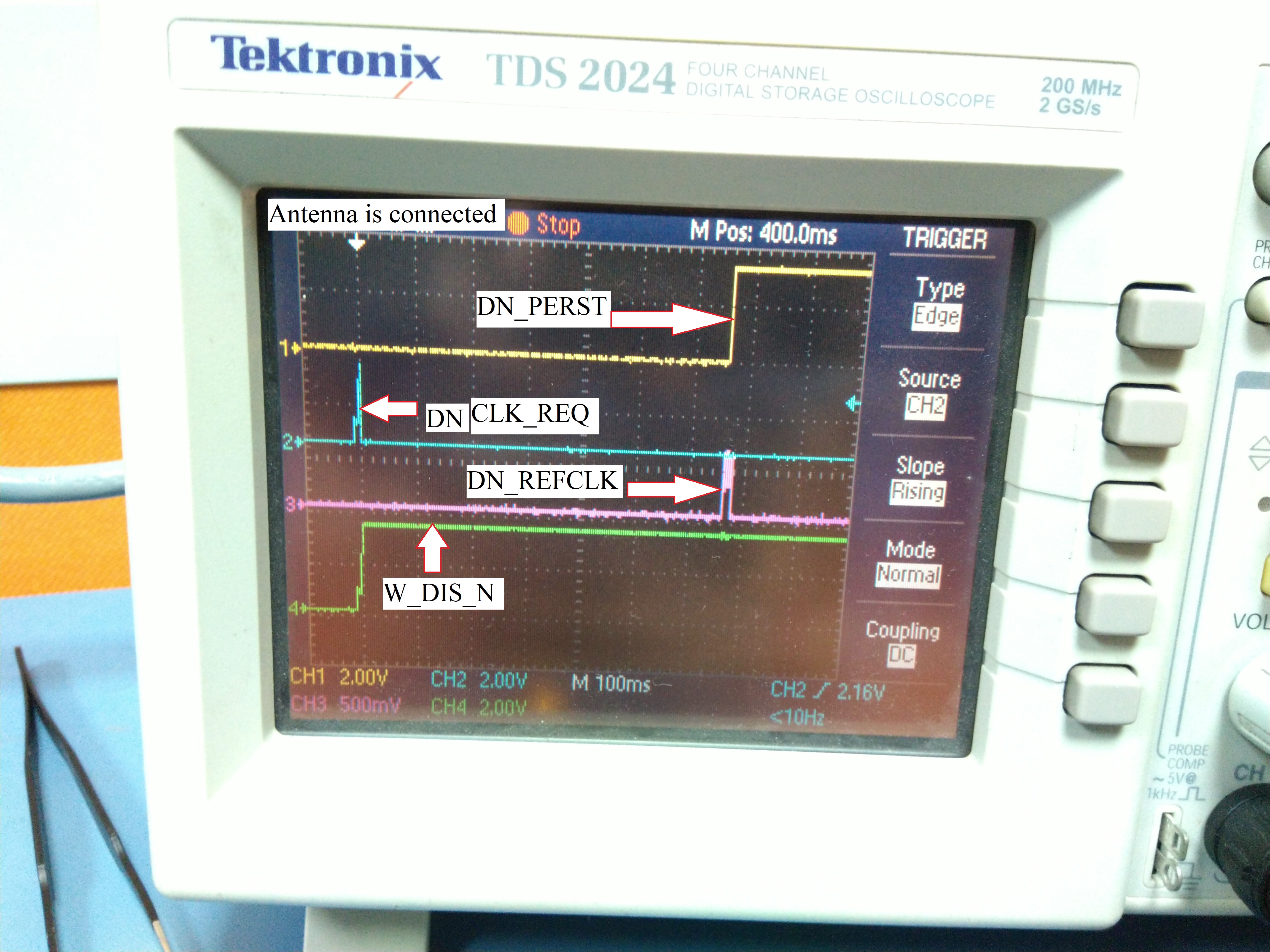

    Today I have take reading for the Signals between Antenna Board and XIO3130.
    Please check the Images along with Test sheet including reading of each signal.
    Observation:-
    1) Radio1_REFCLKn is generated only for 10ms for Down stream and then disable.
    2) Radio1_REFCLKn and Radio1_PERST_N are move for Low to High at same time, there is no any delay between them.
    3) At Power ON, Signals RADIO1_W_DIS_N, PCIE_WAKE_123 and Radio1_Clkreq are first stay at 1V for 10ms and then reach 3.3V.
    Kindly check the reading and Images. Also check voltage level and signal sequence of the signal and share valuable your thought.
    Alpesh.

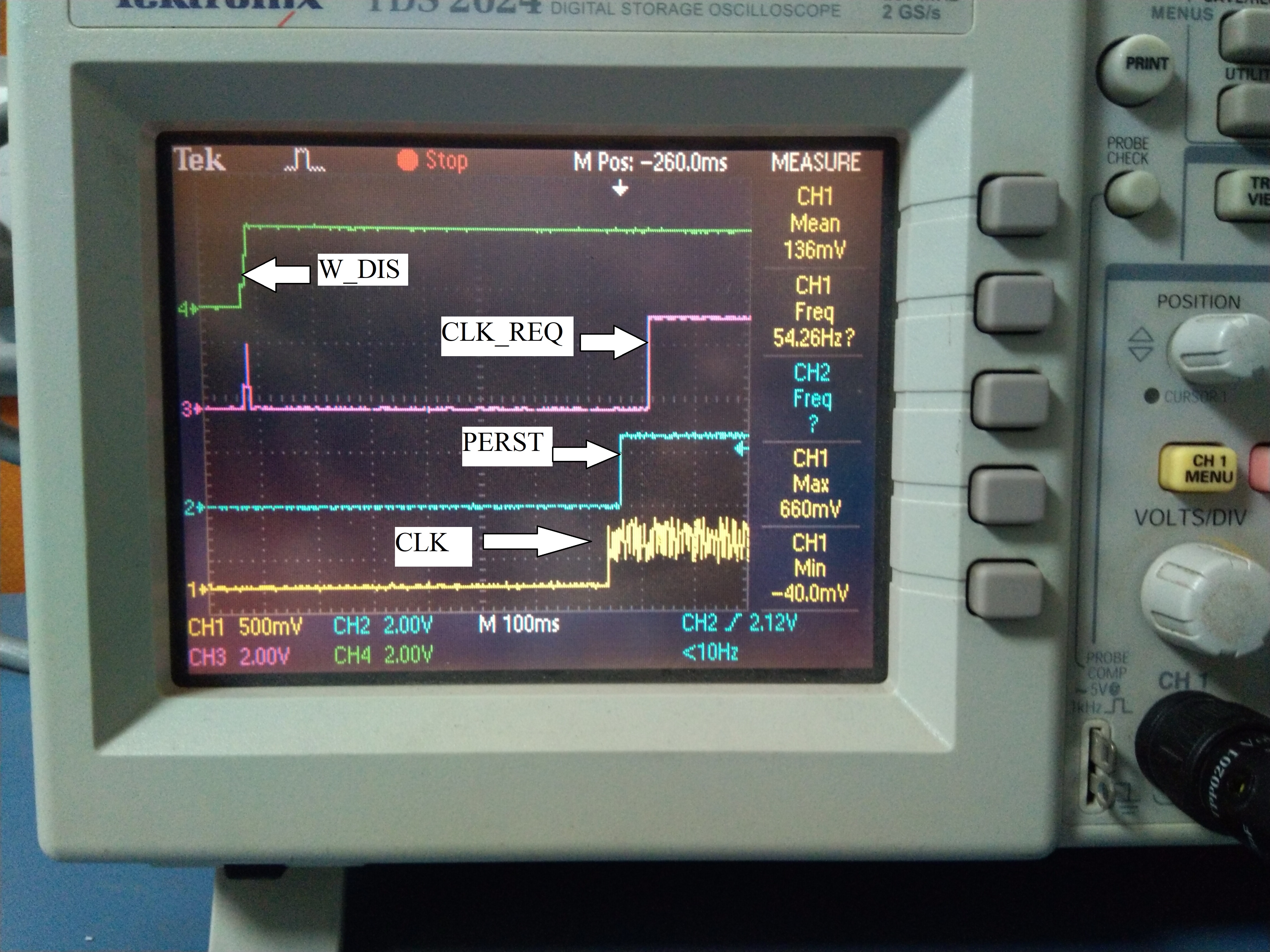

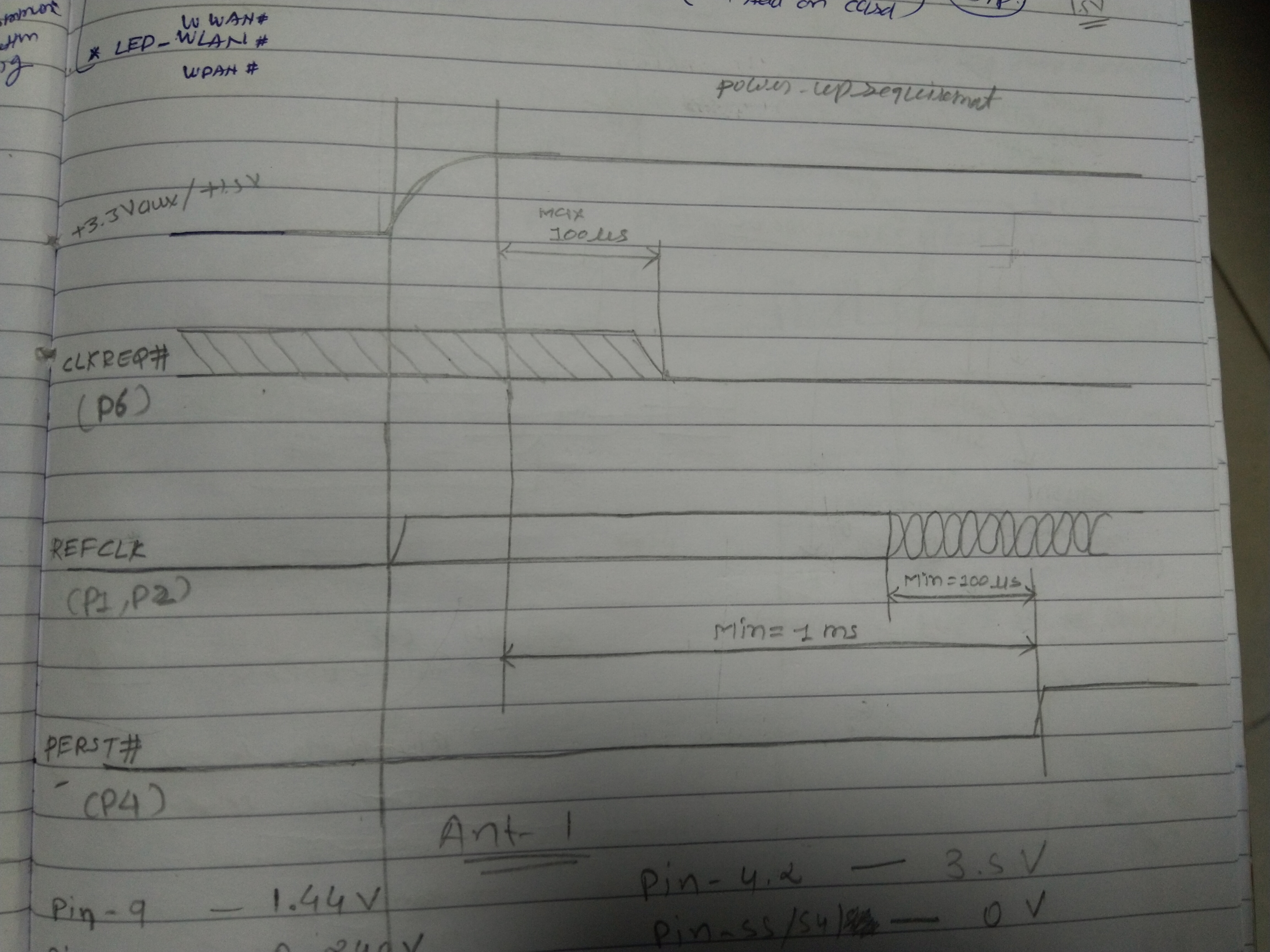

  • Hello I.K.,
    Antenna Board is Third Party Board who has a pattern for customize Antenna and he is using some Qualcomm/Atheros Module for same.
    Antenna Board Manufacturer suggest to follow "PCI_Express_Mini_CEM_12.pdf" for signal sequence.
    I have attached the same pdf for your reference.
    I have also prepare the diagram from the same pdf for this project which is attached here.
    Below is our Testing Observation.
    1) CLK REQ_L => It is high before the Antenna module inserted and become low after Antenna module inserted, meaning the board is hand shaking with the module => Correct behavior
    2) PERST , WIFi DIs => They were Low before Antenna module inserted and both were high afterward ====> Correct behavior
    3) PCIE_CLK should have been generated. However there was no CLK signal.====> PCIE switch need to generate clock.
    As per my understanding from above mentioned pdf below is the steps for power sequence,
    • First,3.3V would be Stable
    • CLKREQ would be low within 100uS wrt the 3.3V.
    • REFCLK would be start around 9mS wrt the 3.3V.
    • PERST would be High after 1mS wrt 3.3V.
    In our case,
    1) PCIE_CLK is generated only for 10ms in Down stream and then disable(Low).
    2) PCIE_CLK and PERST are move for Low to High at same time. Is there any delay required between them ? If yes, How this delay will be controlled or vary?
    3) Here the CLK REQ signal is Low, even though the clock is not in stable state.
    Please refer the Testing Images in previous conversation.
    Kindly share your thought.
    Alpesh.

  • Hi alpesh,
    From the above, I believe the issue is that the downstream clock is trying to come up at the same time that the downstream PERST# is deasserted. So I believe you'll need to find a way to delay the PERST# deassertion to provide enough time (~100us) for the downstream clock to generate. Can you try adding a capacitor on the downstream PERST# to generate the delay?
    I.K.
  • Hello I.K.,
    Thanks for the suggestion.
    Sorry for the late reply as I am trying to take different iteration of EEPROM configuration file.
    As per your suggestion, I have tried by placing capacitor(different values) on PERST signal to generate delay but not succeed to get Clock.
    Then we will cut the PERST trace on PCB and add RC time delay circuit using 10K(POT) and 10uF.
    When we keep the resistor value more than 1.4K, the clock will generate successfully and below 1.2K, the clock will not generate. Here there is Normal Mode file(Provided by TI) is in EEPROM.
    Result:-
    CLOCK is generated by adding RC Delay with Normal mode file inside EEPROM.
    Observation:-
    when we program the EEPROM with Normal mode file provided by TI and use RC delay timer, the clock is generated properly. But when I changed the same file to other/modified file, which was also getting from TI XIO3130 Forum with modified register value as per user application requirements, with same RC delay timer, the clock is not generated.
    Please find the EEPROM files - Normal Mode (TI) and Modified file.
    We are eager to know about the EEPROM file changes responsible for Clock generation.
    Kindly check the EEPROM files and share your view.
    Alpesh.
