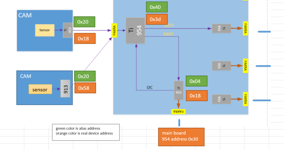

       We have a design for long chain 954/953 connection as below:
         CPU-->954---->953---->[954--->953---->sensor]
         How CPU can configure remote 954/953/sensor(red one) through the first 954/953 using FPD-Link III?
         How I2C operation can be passed to the remote 954/953/sensor?

  • Hello Hamzeh,
        The I2c address for each device is shown as below:
        no need to config camera sensor(output data automatically), so i didn't show it's i2c address.

    CPU --> 954(A) --> 953(A) --> 954(B) --> 953(B)
    so i2c address are:
    954(A):0x30
    953(A):0x18, alias 0x04
    954(B):0x3d, alias 0x40
    953(B):0x18, alias 0x20

  • Hello Hamzeh,
            I tried another sensor module using 913, 954(B) still can't load 913's address automatically. this module's 913 adress is 0x58, is different from 953(A).
            I draw a picture for sensor module using 953 and 913:

  • Hello Hamzeh,
            We have found out that the 954(B) can't lock 953(B) problem is caused by hardware issue. After fix the hardware issue, 954(B) and 953(B) can LOCK now.
            But the i2c access to 953(B) is actually responsed by 953(A).
            It seems 953(A) and 953(B) can't have the same real i2c address.
    Best regards
  • Yes, please change the I2C address of one 953 device and adjust your settings in 954(A) accordingly.
