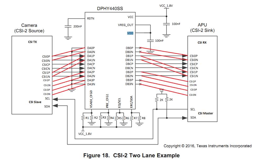

May I reserve 4 Lane schematic as below but use same PCBA for both 2 Lane & 4 Lane ?

Is this a CSI-2 or a DSI application?

With CSI-2, the lane order does not matter. With lane 0 being a special bi-directional lane, I would recommend not using lane0 when switching to the 2-lane CSI design. In this case. lane 0 from the camera will connect to DA1 of the DPHY440, and lane 1 from the camera will connect to DA2 of the DPHY440. Either lane 2 or 3 can be connected to DA0 and DA3 of the DPHY440. Please make sure the DB output follows the same lane order of DA input.
