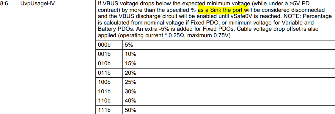

TPS65982: UVP Point setting in FW
Part Number: TPS65982
  When we do not set Under-voltage Protection to 4.5V always.  and we set Under-voltage Protection Trip Point, PP_5V and PP_HV to 50%,
  My question is :
   When 982 role is sink, and we suppose negotiated PDO is 20V, when VBUS voltage is below 10V, UVP point is triggered.
    When 982 role is source, and we suppose negotiated PDO is 20V, when VBUS voltage is below 10V, will UVP point also be triggered?
    Or when 982 role is source, Will the Uvp point be triggered when below 5% of negotiated PDO ( compared with normal Voltage). For example, when negotiated PDO is 20V, and 982 is source, UVP will be triggered when VBUS voltage under 19V ( 20V-20V*5% = 19V)?
