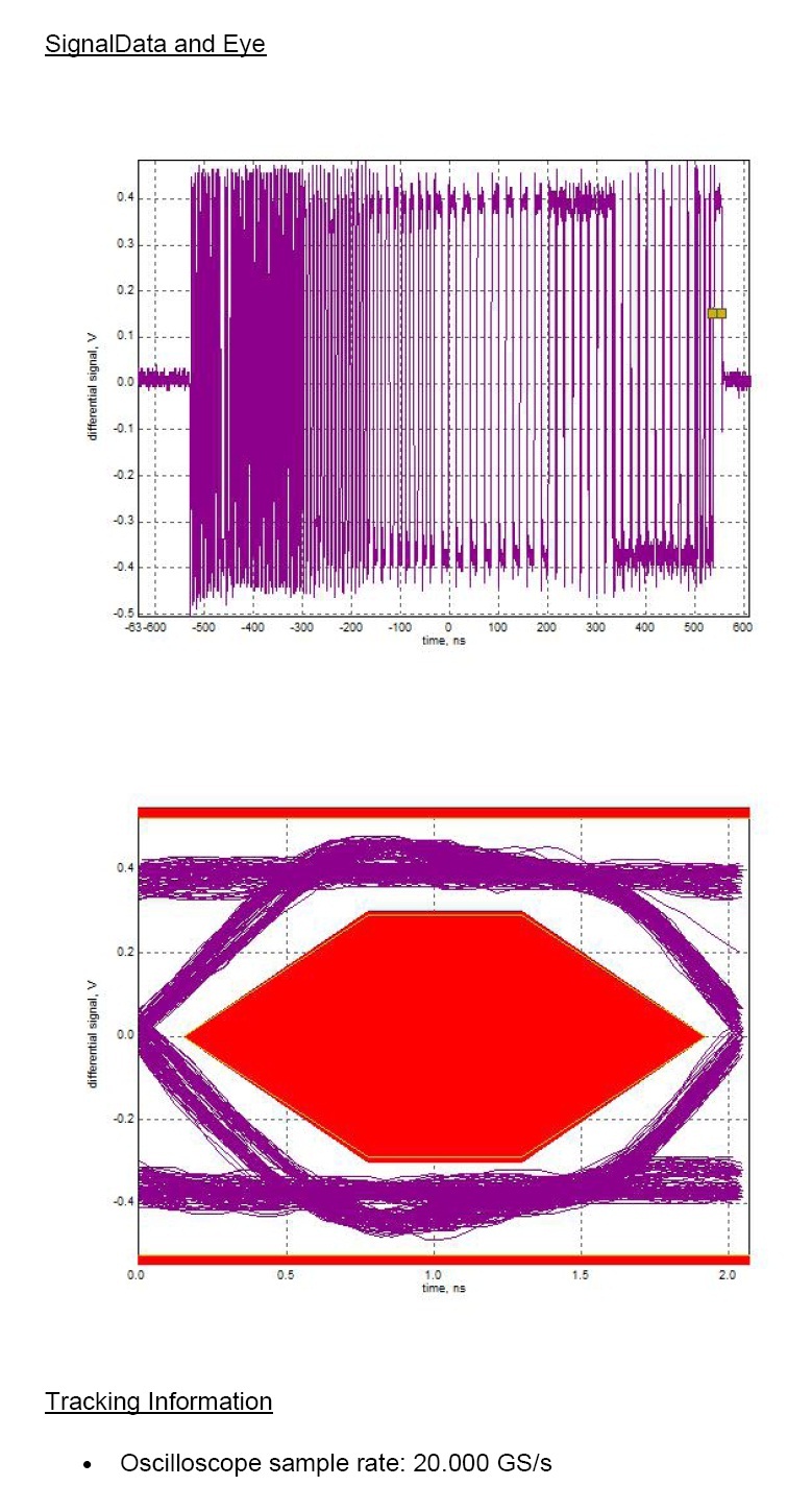

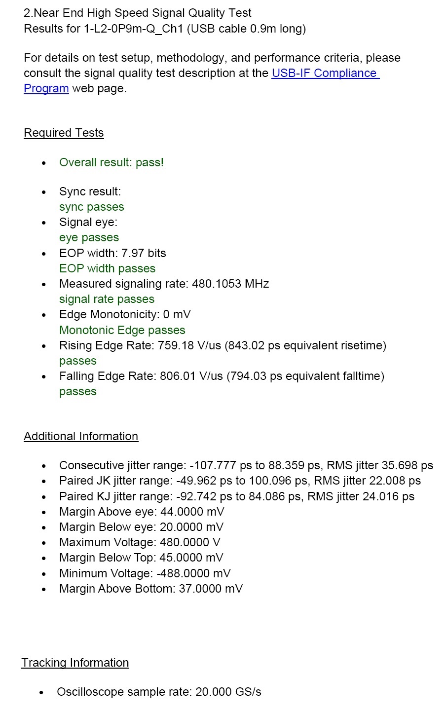

Hi,Thank you for your reply.
This is the Eye diagrams of our test,BOOST=level 2 and RX_SEN=high,Pre=0.9 meters,Please help us to assess whether it meets the standard requirements for Eye diagrams.
Thanks for your answer!

Eye diagrams, in general, should be judged by whether they violate the eye mask (i.e. red keep out portion)to determine whether they meet the minimum requirements. I would say the above diagram is good because it does not violate the eye mask per the USB2 eye test. Does this answer your question? Please read section 10.1 Layout Guidelines of the datasheet to answer your second question.
