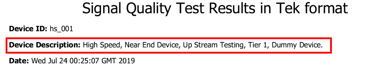

We've received the  DVT MB (with TUSB212).
Althoughi DVT MB pass the USB2.0 test, but the jitter is worse than EVT.
Is there any way to improve the jitter through TUSB212?

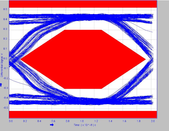

Here is the U2 margin pass eye diagram for you to reference.
For jitter issue, may we lower the AC boost level to lower the jitter?
Update-
We find change to high level of ac boost will let jitter be more obviously. If enhanced dc & ac boost level to max, can have more margin, but will also reduce V-swing tolerance.
Due to can't find any emphasis tuning option, do you have other ideas for this ?
Fig-1. DC boost = L ; AC boost = level 1  (default)

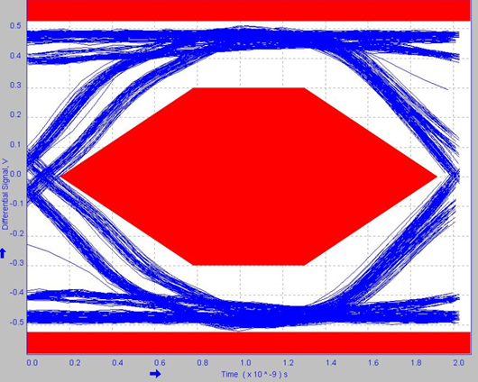

Fig-2. DC boost = L ; AC boost = level 3

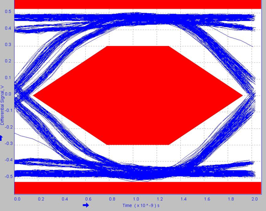

Fig-4. DC boost = H ; AC boost = level 3

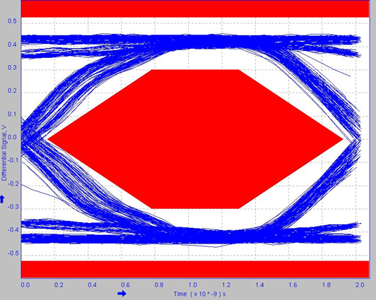

Fig-5. DC boost = L ; AC boost = level 0

    Could you describe the application and what are the distances between USB host, TUSB212 and connector? Most of the eye diagrams (fig 2 - 4) posted exhibit large amounts of over equalization which can look like jitter but is not the same. In Fig-1 there does seem to be some jitter. Are you meeting the USB 2 jitter specification with your default settings? Is there a common mode choke in the USB 2 path? How does the eye look once this common mode choke is removed?

    From Fig.1, can see if set DC boost = LOW , AC boost = Level 0 , then the Jitter (?) will be more like the result of level 3 AC boost behavior, and still is margin on the left side of eye diagram.
    From Fig.2, can see if remove CMC on USB2.0 signals, it will fail and still is margin to TOP/BTN side.  (It can pass by retesting several times, but also can be fail during the process.)
