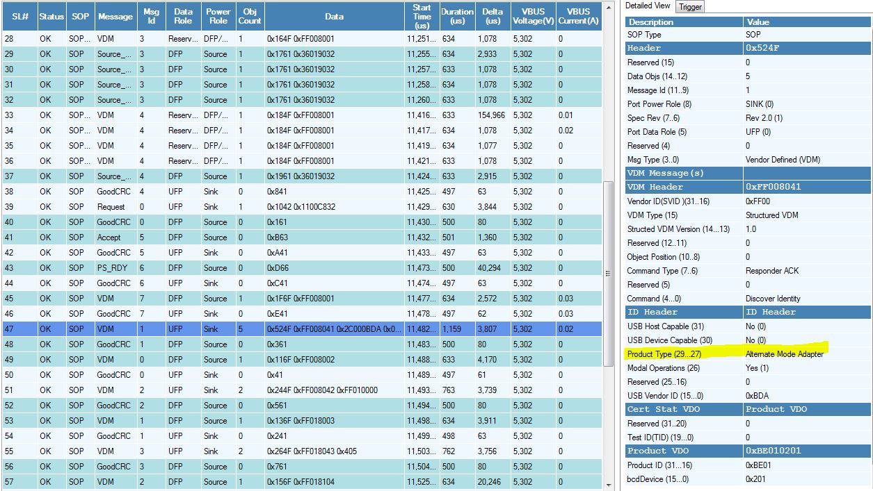

  • One more thing that I want to mention; that our TPS65987D based device in Discover Identity message says that it is a Product type "Periferal".
    But the cable is responding as Alternate Mode Adapter.
    My question is, is this a source of the problem, and if it is, how we can change the Prodct Type.
    Aleksey

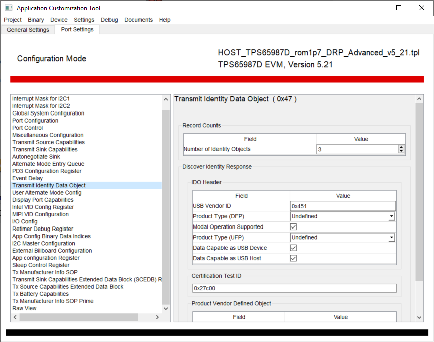

  • Hi Aleksey,
    The advanced mode is also available for TPS65987 device. I was able to select that device and configure it as a DFP. Once that's loaded in the GUI, you can configure the "Product Tpe" in the "Transmit Identity Data Object register (0x47). Here is a screenshot of the option in the GUI where you can select it as a peripheral.
    Thank you,
    Hari

  • Hi Aleksey,
    You may have an older version of the GUI, I was able to access the advanced configurations using the GUI from TI's website that I can link below. You should see an option to select TPS65987DDH on the GUI and configure it accordingly. From there, you should be able to create your own project file for the particular device.
    http://www.ti.com/tool/TPS6598X-CONFIG
    Thank you,
    Hari
  • Hi Hari,
    Thanks for the link. I was able to load advanced mode project file for TPS65987D and made it work for CromeBook.
    Now it responds as Alternate Mode Adapter in Discover Identity message to CromeBook.
    However, with Samsung S10e nothing have change. In same massage it responds as Peripheral, also I have unchecked to boxed for USB Device and Host in GUI, but in the message it stays present.
    Another interesting behavior that I have noised; with CromeBook it is doing DR_Swap before correct Discover Identity message.
    But, with Samsung phone its doing Discover Identity immediately after getting a power.
    Any idea how we can correct that?

  • One more thing Hari,
    A I see from the picture you provided, GUI version is 5.21, from the link that you gave I was able ti download GUI Version 5.13.
    Your GUI have two select box for UFP and DFP. The one that I have access to has only one select box.
    How can we get Ver 5.21?
    Aleksey
  • Hi Aleksey,
    The Discover Identity congifuration will not impact the DisplayPort Alternate Mode entry. The issue may be in the Samsung S10e. From looking at the logs, it seems that the Samsung S10e never offers the DisplayPort Alternate Mode and therefore it's not entered. You may need to enable the Alternate Mode in the S10e's PD controller somehow, possibly via an app. Also, when you connected the Dex cable to the monitor though, it was operating as a UFP and the Samsung S10e was the DFP in that scenario.
    You could try to configure your TPS65987D the same way and see if the Samsung S10e will go into the DisplayPort Alternate Mode that way. You could do this in the GUI by going to the "Port Control" 0x29 register and checking the box labeled "Initiate Swap To UFP" and this will change the Samsung S10e mode so that the TPS65987D will be UFP and the Samsung S10e will be DFP, which is the way it's configured when you connected it to a monitor via Dex cable.
    As for the GUI, the version 5.13 that you have is fine as it's the most updated version that is fully functional. The one that I provided in the screenshot is an internal prototype. Your GUI will be able to handle all the configurations successfully.
    Thank you,
    Hari
  • Hi Hari,
    "Initiate Swap To UFP" check box made it to work.
    Aleksey
