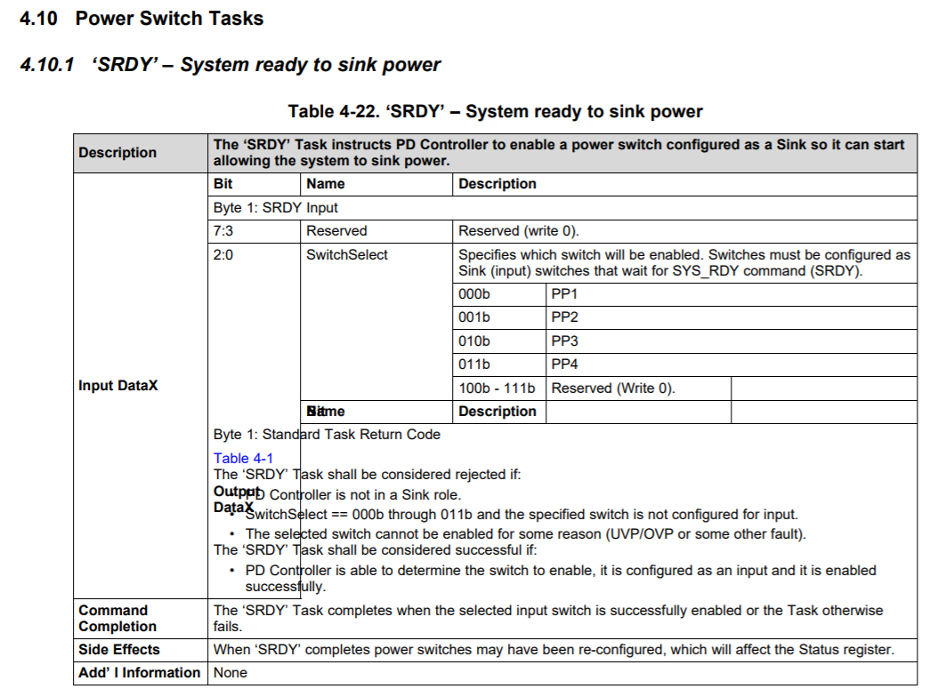

  • Hello Eric
    I have confirmed SRDY from 4.10.1 ‘SRDY’ – System ready to sink power item in the following link.
    The material is overlapped as shown in the attachment, making it a little difficult to see
    and I don't know what is written. Is there anything written correctly?
    DDdoor
  • Hi DDdoor,
    Thank you for pointing this out, I will work with the team to get it fixed. In the meantime, just the Output Data section looks effected. It should read the below:
    The ‘SRDY’ Task shall be considered rejected if:
    • PD Controller is not in a Sink role.
    • SwitchSelect == 000b through 011b and the specified switch is not configured for input.
    • The selected switch cannot be enabled for some reason (UVP/OVP or some other fault).
    The ‘SRDY’ Task shall be considered successful if:
    • PD Controller is
    Thank you,
    Eric
