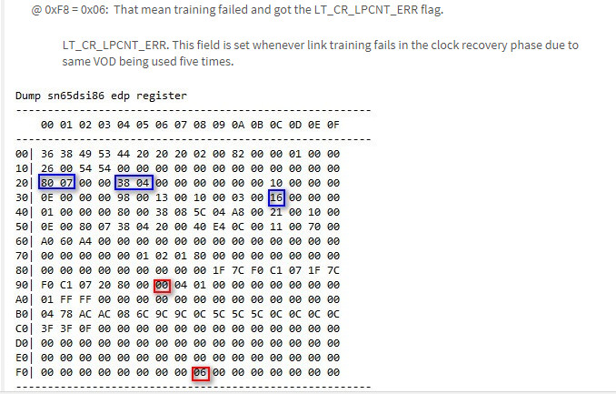

As the last update in case  SN65dsi86 DP link training failure .. https://e2e.ti.com/support/interface/f/138/p/802544/2973823#2973823
Please forget bad broken screen issue.
After comfirm , it's due to the cable wrong pin assign to edp lane.
I have replaced a new correct cable , but the semi-auto link failure issue is still as below dump :
2) After I did the DP training twice times  , The display is normal work .   please give advice ?
