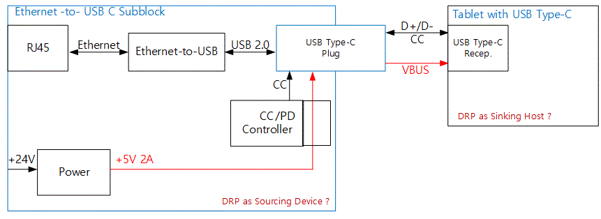

To whom may it concern,
I purchased your product TPS65987EVM as you recommended. (Link: http://e2e.ti.com/support/interface/f/138/t/794868)
Please refer to updated below block diagram.
I have to design "Ethernet-to-USB Subblock".
My purpose is to design "Sourcing Device" which is available for USB 2.0 Communication during charging Tablet(as Sinking Host).
For testinng and verifying,
In side of H/W,

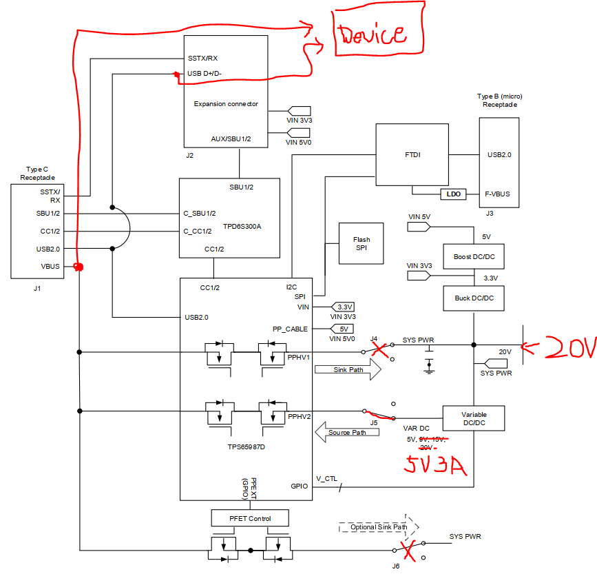

I manually connect TPS65987EVM to USB "Device" as by jumping wires (D+,D-, VBUS, GND) below picture.
"Device" in upper picture is anything like USB Mouse, USB Keyboard, USB-to-Ethernet Adapter, USB Memory Stick, and USB Hub.
My desired USB Device is USB-to-Ethernet Adapter.

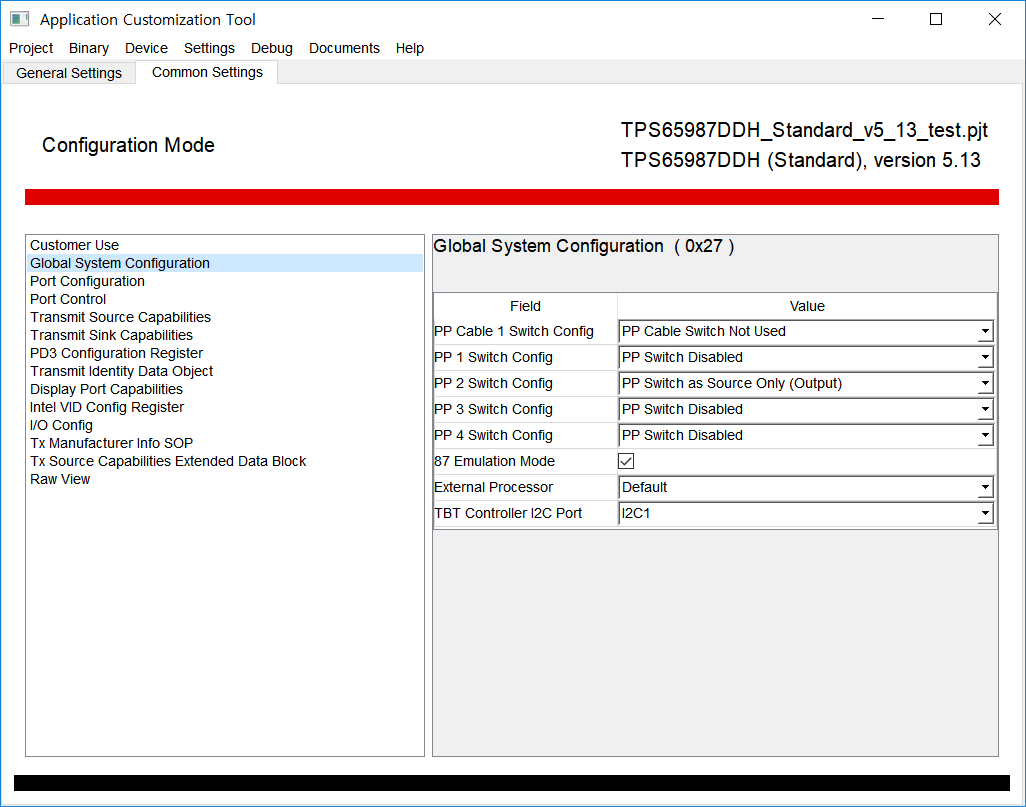

New Project -> TPS65987DDH -> Standard -> Dual Role Port(DRP), prefers power source -> None (Displayport Only)
Until now, I set only 1 PDO(5V 3A) and it is really good well (as DFP/Host initially)
And then, after TPS65987EVM send DR_Swap command for swapping UFP, it looks like OK.
 Because I confirm goodCRC & Accept via USB PD Analyzer.
But, connected my "Device" by jumpping wires is not working. I check VBUS for "Device" and it has no problem.
Please refer to below Register settings. (attacted file is more specific)
TPS65987DDH_Standard_v5_13_test.pjt

REGISTER: Global System Configuration (0x27) - (0x7800000014140080000000080000)
FIELD:[0:1]Global System Configuration::PP Cable 1 Switch Config-Value:(0x0)PP Cable Switch Not Used
FIELD:[2:3]Global System Configuration::PP Cable 2 Switch Config-Value:(0x0)PP Cable Switch Not Used
FIELD:[16:18]Global System Configuration::PP 1 Switch Config-Value:(0x0)PP Switch Disabled
FIELD:[19:21]Global System Configuration::PP 2 Switch Config-Value:(0x1)PP Switch as Source Only (Output)
FIELD:[32:34]Global System Configuration::PP 3 Switch Config-Value:(0x0)PP Switch Disabled
FIELD:[35:37]Global System Configuration::PP 4 Switch Config-Value:(0x0)PP Switch Disabled
FIELD:[55:55]Global System Configuration::87 Emulation Mode-Value:(0x1)True
FIELD:[56:56]Global System Configuration::PP1 Switch to VBUS Map-Value:(0x0)VBUS 1
FIELD:[57:57]Global System Configuration::PP2 Switch to VBUS Map-Value:(0x0)VBUS 1
FIELD:[58:58]Global System Configuration::PP3 Switch to VBUS Map-Value:(0x0)VBUS 1
FIELD:[59:59]Global System Configuration::PP4 Switch to VBUS Map-Value:(0x0)VBUS 1
FIELD:[60:63]Global System Configuration::Reserved-Value:(0x0)Reserved, set 0

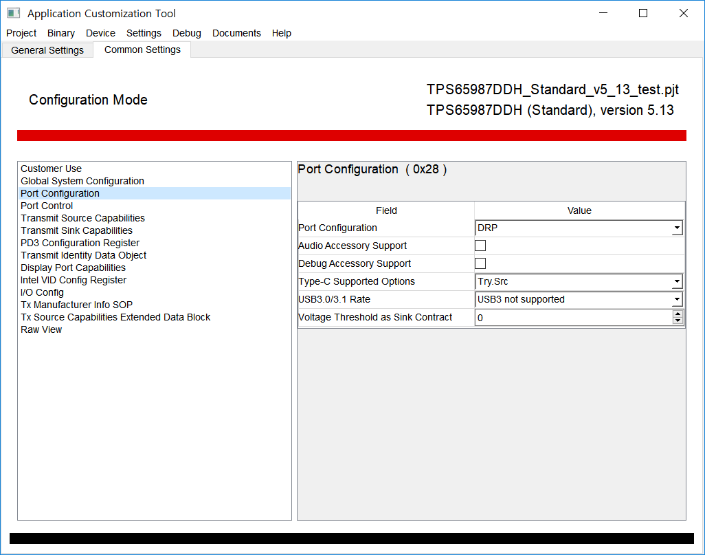

REGISTER: Port Configuration (0x28) - (0x1dfb6190a)
FIELD:[0:1]Port Configuration::Port Configuration-Value:(0x2)DRP
FIELD:[2:2]Port Configuration::Reserved-Value:(0x0)Reserved, set 0
FIELD:[3:5]Port Configuration::Receptacle Type-Value:(0x1)Standard fully-featured USB-C receptacle
FIELD:[6:6]Port Configuration::Audio Accessory Support-Value:(0x0)False
FIELD:[7:7]Port Configuration::Debug Accessory Support-Value:(0x0)False
FIELD:[8:9]Port Configuration::Type-C Supported Options-Value:(0x1)Try.Src
FIELD:[10:10]Port Configuration::Reserved-Value:(0x0)Reserved, set 0
FIELD:[13:14]Port Configuration::USB3.0/3.1 Rate-Value:(0x0)USB3 not supported
FIELD:[15:15]Port Configuration::Reserved-Value:(0x0)Reserved, set 0
FIELD:[16:16]Port Configuration::Set UVP to 4.5 V-Value:(0x0)False
FIELD:[17:19]Port Configuration::Under-voltage Protection Trip Point, 5V-Value:(0x3)20%
FIELD:[20:22]Port Configuration::Under-voltage Protection Trip Point, >5V-Value:(0x3)20%
FIELD:[23:28]Port Configuration::Over Voltage Protection Trip Point-Value:(0x3f)24V
FIELD:[29:30]Port Configuration::Over Voltage Protection Trip Point-Value:(0x2)Disconnect VBUS if voltage exceeds 10% of expected max.
FIELD:[31:31]Port Configuration::Over Voltage Protection Trip Point-Value:(0x1)Warning when source VBUS voltage exceeds 20% from nominal
FIELD:[32:32]Port Configuration::Over Voltage Protection Trip Point-Value:(0x1)Warning when source VBUS voltage dips below 20% from nominal
FIELD:[33:34]Port Configuration::Over Voltage Protection Trip Point-Value:(0x0)0.41 V/mS typical
FIELD:[35:39]Port Configuration::Reserved-Value:(0x0)Reserved, set 0
FIELD:[40:47]Port Configuration::Voltage Threshold as Sink Contract-Value:(0x0)0

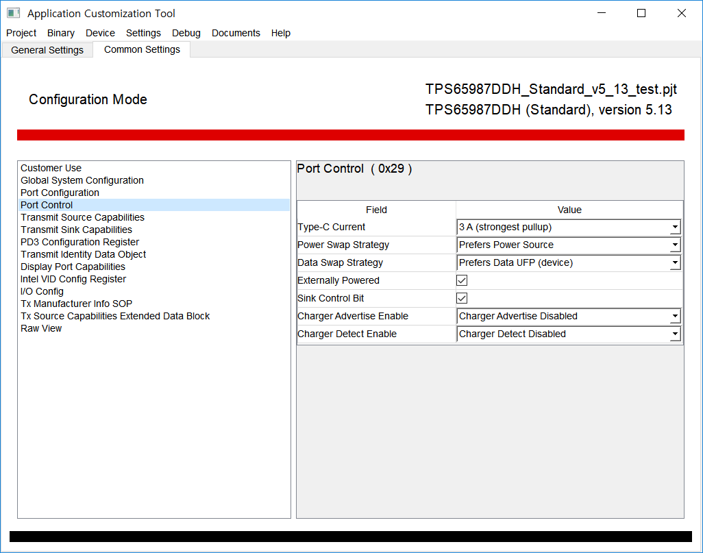

REGISTER: Port Control (0x29) - (0x3934c2)
FIELD:[0:1]Port Control::Type-C Current-Value:(0x2)3 A (strongest pullup)
FIELD:[2:3]Port Control::PD Mode-Value:(0x0)Normal PD Behavior
FIELD:[0:1]Port Control::Power Swap Strategy-Value:(0x2)Prefers Power Source
FIELD:[4:4]Port Control::Process Swap To Sink-Value:(0x0)False
FIELD:[5:5]Port Control::Initiate Swap To Sink-Value:(0x0)False
FIELD:[6:6]Port Control::Process Swap To Source-Value:(0x1)True
FIELD:[7:7]Port Control::Initiate Swap To Source-Value:(0x1)True
FIELD:[8:8]Port Control::Reserved-Value:(0x0)Reserved, Set 0
FIELD:[9:9]Port Control::Reserved-Value:(0x0)Reserved, Set 0
FIELD:[10:10]Port Control::Process VCONN Swap-Value:(0x1)Enabled
FIELD:[0:1]Port Control::Data Swap Strategy-Value:(0x3)Prefers Data UFP (device)
FIELD:[12:12]Port Control::Process Swap To UFP-Value:(0x1)True
FIELD:[13:13]Port Control::Initiate Swap To UFP-Value:(0x1)True
FIELD:[14:14]Port Control::Process Swap To DFP-Value:(0x0)False
FIELD:[15:15]Port Control::Initiate Swap To DFP-Value:(0x0)False
FIELD:[16:16]Port Control::Automatic ID Request-Value:(0x1)Enabled
FIELD:[17:17]Port Control::Reserved-Value:(0x0)Reserved, set 0
FIELD:[18:18]Port Control::Force USB Generation 1-Value:(0x0)False
FIELD:[19:19]Port Control::Externally Powered-Value:(0x1)True
FIELD:[20:20]Port Control::Automatic Sink Cap-Value:(0x1)True
FIELD:[29:29]Port Control::USB Disable-Value:(0x0)False
FIELD:[21:21]Port Control::Sink Control Bit-Value:(0x1)True
FIELD:[22:23]Port Control::Reserved-Value:(0x0)Reserved, set 0
FIELD:[24:24]Port Control::15 kOhm Resistor Present-Value:(0x0)False
FIELD:[25:25]Port Control::Data Contact Detection Enable-Value:(0x0)False
FIELD:[26:28]Port Control::Charger Advertise Enable-Value:(0x0)Charger Advertise Disabled
FIELD:[30:31]Port Control::Charger Detect Enable-Value:(0x0)Charger Detect Disabled

What can I do any more for operating and for checking?
Do I need to some operating sequence?
Please give me opinions.
