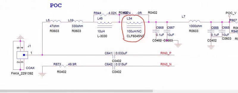

Part Number: DS90UB953-Q1
HI TI employees
We used ds90ub953/954 to design the camera scheme, but we found that sometimes I2C did not respond. Our design drawing is slightly different from the reference design of TI, in which the large inductance of 100uH is not added, is it possible that this is the cause of this problem
