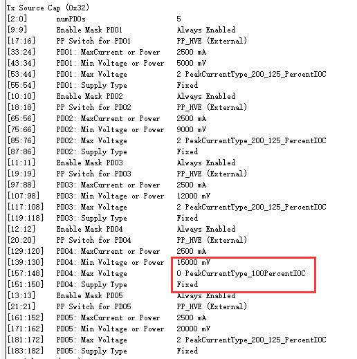

3.  Figure below shows the 0x32 register of TPS65982, 15V PDO Peak current always keep at 100% and can’t change by the firmware configure tool.
  Is there any bugs about this?

    3. Why the register 0x32 shows that  15V PDO Peak Current always keep at 100%? Is there any answer?
  • Hi Picher,
    Your summary looks correct. Please ensure you are setting the correct IOC setting for the 15V PDO as well.
    Eric
  • Hi, Eric
    Thanks for your help.
    I'm sure I have set the correct IOC setting for 15V PDO same with other PDOs. And the other PDOs is set as expected, except 15V PDO is alway keep at 100% IOC.
    And if firmware sets 5V PDO to feed PP_VBUS via internal switch (PP_5V0 to PP_VBUS path) as default: 15V PDO OCP happens at nominal 5.4A (2.5x200%) as expected (firmware tools settings: Maximum Current = 2.5A and Peak Current = 150% or 200%).
    But if firmware sets 5V PDO to feed PP_VBUS via external switch (PP_EXT to PP_VBUS path) as default: 15V PDO OCP happens at nominal 2.5A (2.5Ax100%) (not 5.4A) (firmware tools settings: Maximum Current = 2.5A and Peak Current = 150% or 200%).
    So, is the 5V PDO must to set to feed PP_VBUS via internal switch (PP_5V0 to PP_VBUS path) as default ?
    Picher
  • Hi Picher,
    It is recommended to use the internal 5V path to source 5V to VBUS. This internal power path was designed and optimized for the 5V source use case. The best performance and protection will be realized when using the internal 5V path.
    Eric
