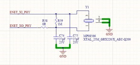

DP83867E: PHY is not visible (read of any register returns 0xFF92) on MDIO
Part Number: DP83867E
Other Parts Discussed in Thread: AM5728, TPS659037, PMP
we are developing for a customer a custom board based on TI AM5728 controller and experiencing now such a problem that Ethernet PHY DP83867E is not visible in u-boot (all PHY register reads return 0xFF92 value). The PHY is used in RGMII mode.
Our hardware engineers checked, that all voltages (3.3V, 2.5V and 1.0V) and 25 MHz frequency are present, pins RESET_N and INT/PWDN are set high, MDIO pin is pulled-up according to the datasheet. Both pins GPIO_0 and GPIO_1 are isolated. RBIAS has 11k resistor on it (see below).
The reference frequency 25 MHz is sourced like here
MDIO pin is pulled-up with 2.2k to VDDO 3.3V like here
We are using ti-processor-sdk-linux-am57xx-evm-05.02.00.10 and below you can see u-boot startup console output (I also added some additional prints).
Attached you find board-specific device-tree files and complete device-tree generated during u-boot building.
We need a solution for the problem very urgently and look forward hearing from you as soon as possible.

  • Hi Timur,
    What is the load cap value of the crystal you are using?
    Can you probe MDIO/MDC to show us a read waveform please?
    How many devices are on the MDIO bus, just one?
  • Hi Ross,
    here are the anwers:
    1)      Crystal data: frequency 25 MHz (it was measured), stability 50 ppm, tolerance 20 ppm. According to 9.2.1.3 Crystal recommendations of the datasheet both capacitors CL1 (XI) and CL2 (XO) are 27pF and load capacitor 18pF, R1 is 0Ω.
    2)      we made again the following measurements today and found that the crystal frequency is exactly 25 MHz, VDDIO is on 3.3V, VDDA is on 2.5V and VDD1P0 1.0V. The PHY shouldn’t be in reset: INT_PWDN (pin 44) and RESET_N (pin 43) are both on 3.3V. Measurement on MDC (pin 16) gave ~500kHz. On MDIO no any data transactions were detected (pin 17 was permanently on 3.3V level).

  • Hi Timur,
    From your schematic, it looks like you are trying to set PHY ADD to 0x1.
    Even though the scan says there are no devices on the bus, can you try and see if 0x1 responds?
    Do you see RX_CLK toggling?

  • Hi Ross,
    as you asked, we made some additional measurements and found the following:
    -          all voltages on DP83867E PHY are stable and correspond the datasheet
    -          the PHY is neither in power down nor in reset
    -          the reference clock for the PHA is 25 MHz and it is stable (see 25MHz_OSC_PHY.png)
    -          the reference clock for the AM5728 is 20 MHz and it is stable (see 20MHz_OSC_AM5728.png)
    -          MDIO_CLK (MDC) is 488 MHz and it is stable; MDIO_DATA is permanently high (see MDC.png)
    -          RGMII_TX_CLOCK (from AM5728 to the PHY) is always 25 MHz independently whether Ethernet cable is plugged in or not (see PHY_TX_CLK_IN.png)
    -          RGMII_RX_CLOCK (from the PHY to AM5728) is 125 MHz if Eth cable is plugged in
    and ~16 MHz if no cable is plugged
    It looks like the PHY is alive and working but the MDIO does not function despite the MDIO controller in AM5728 is enabled by CPSW MAC driver (MDIO_CLK is present).
    By the way you are right, according to our schematic we configure PHY addr 0x01, but to exclude false strapping resistor we removed it and work now with default PHY addr 0x00.
    We hope the provided information will give you a hint what is going wrong.
    We look forward hearing from you as soon as possible.
    Timur.
