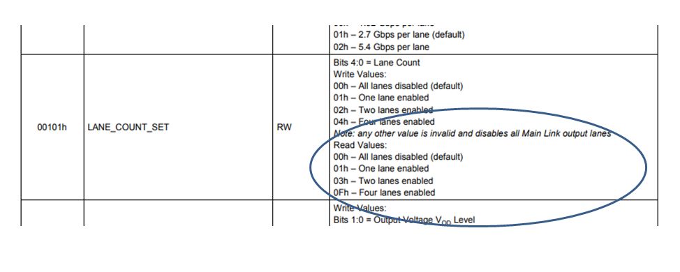

    am I doing something wrong ?
    I also can read from manual (http://www.ti.com/lit/ds/symlink/sn75dp130.pdf) page 21 that read value from DPCD 101h should be 02h for four lines but sink UG (http://www.ti.com/lit/an/slla349/slla349.pdf) page 5 tells that I should get 0Fh so whats rigth ?
  • Joe
    Please try to disable the squelch by writing the value of 0x08 to register 0x0x3h.
    Where do you see reading 0x02 for 4 lanes in the datasheet?
    Do you have HPD_SNK going high?
