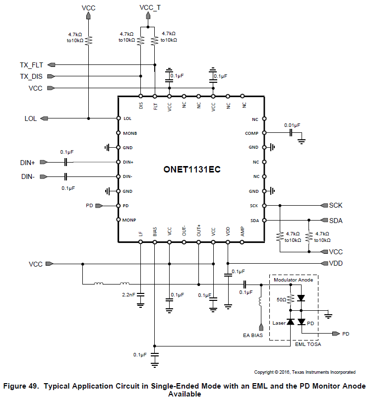

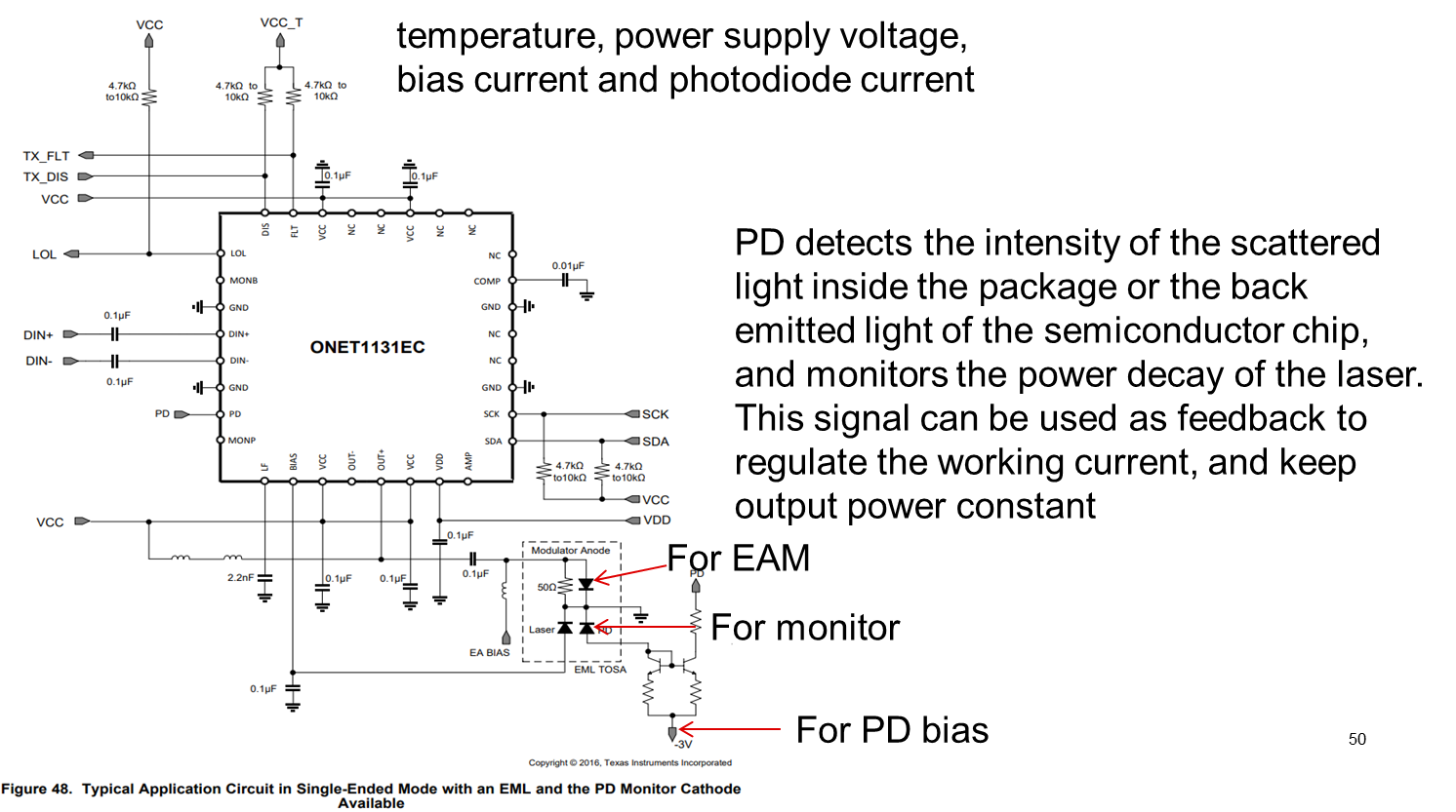

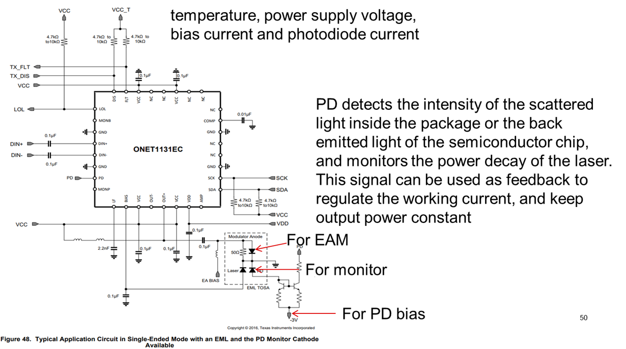

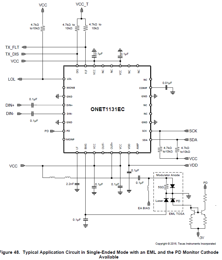

Hi Team,
I have two question about below schematic,
1. for the EML TOSA, it has three diodes, Laser diodes are used to emit lasers; PD is used to detect laser emission power; what is the use of other one?
2.I see two structures of the below schematics are EML type, we know EML bias need negative voltage; does it mean for figure 48, we need two negative voltage for EML bias and PD driver; for figure 49, we just need one negative voltage for bias ?
