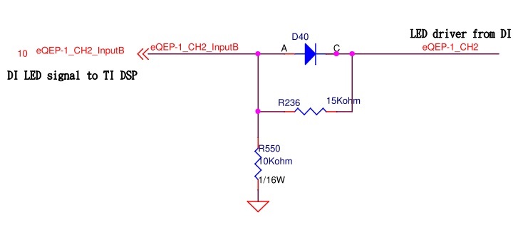

Hi Shawn,
Thank you for that information.
I would like to point out that your system has a value of RLIM that is smaller than the value that was used in the test conditions in the data sheet (25 kOhm), which is resulting in a much larger I(IP-LIM) than the maximum of 4 mA . My suggestion is to increase the value of RLIM so that I(IP-LIM) falls within the specified range.
Could you help me understand if the anode or cathode node of the diode is connected to the input REx?
In regards to your second question, CE and LD cannot be connected to the same source. According to Table 2 in the data sheet, LD and CE must be opposite (LD high and CE low) in order to enable shifting to generate SOP data.
Kate
Hi
REx connect to F280049CPMS , not LED.
So, REx can be run 100K from IPx?
attach is my schematic.
RLIM will change to 330k//30kohm =27.5K Ilim=3.25mA
Q2.
LD connect to GPIO is OK.
ShawnDI_SN65HVS885-2.pdf

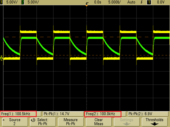

Hi Shawn,
I was able to measure the waveforms of the input IP0 (shown below in yellow) and the output RE0 pin (shown below in green) with similar loading to your system.
The slope on the output waveform is due to the switching time associated with the parasitic capacitances of the current limiter circuit and load resistance. This return path (REx) was designed to be an LED driver and does not have the bandwidth to support this application at this frequency.
Kate
Hi Shawn,
My suggestion is to reduce the load resistance to reduce the fall time.
I would like to reiterate that this return path (REx) was designed to be an LED driver and does not have the bandwidth to support this application at this frequency.
