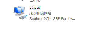

Based on the 3354 platform, the previous PHY is DP83848. The reset is controlled by power-on reset and GPIO through AND gate. Now the replacement to DP83822 is only controlled by gpio. The program has not changed. After the replacement, the PHY does not work. The phy pin configuration is the same, but it doesn't work. The computer display can recognize, RXER, RXDV, RX[1:0] have signals, but TXEN, TX[1:0] have no signal.
The network port of the board is directly connected to the computer. After uboot is loaded, the status of the network card is as shown below.
Why is the hardware configuration PHY address is 00011, the actual software reads out 00111, why is it inconsistent?7853.question.pdf
