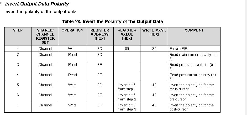

How to operate the polarity reversal of CDR output?I can't change the register according to the manual.Do you have a manual?
The methodology listed on your previous post for polarity inversion is correct. Are you able to perform I2C writes to your retimer device? Webench is not supported for DS250DF410.
