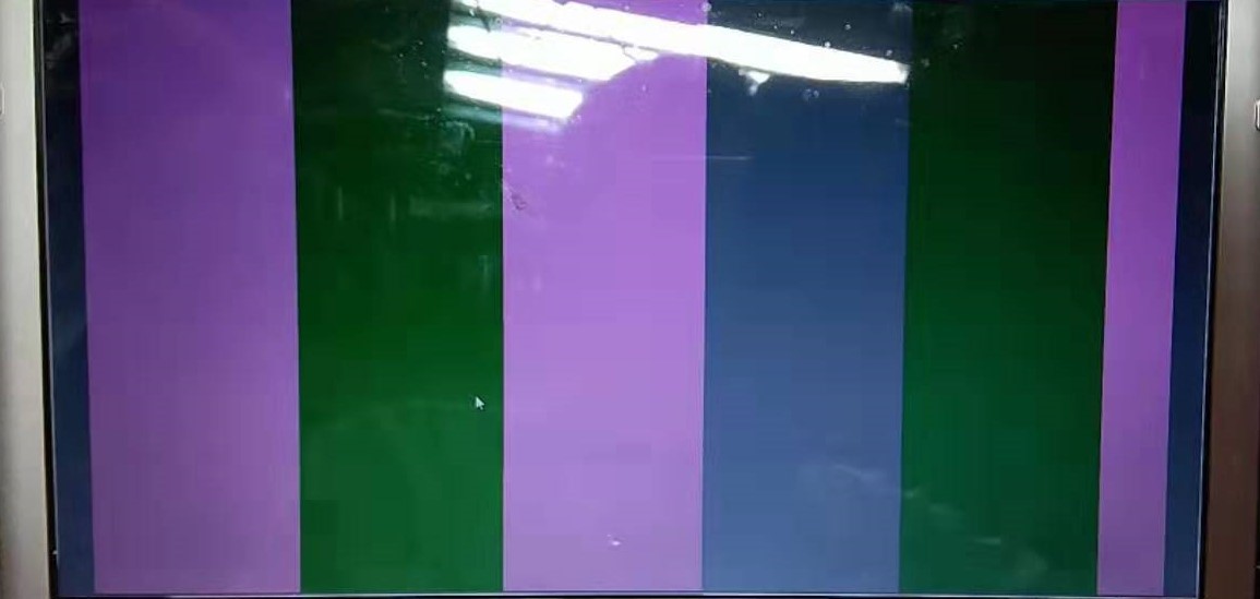

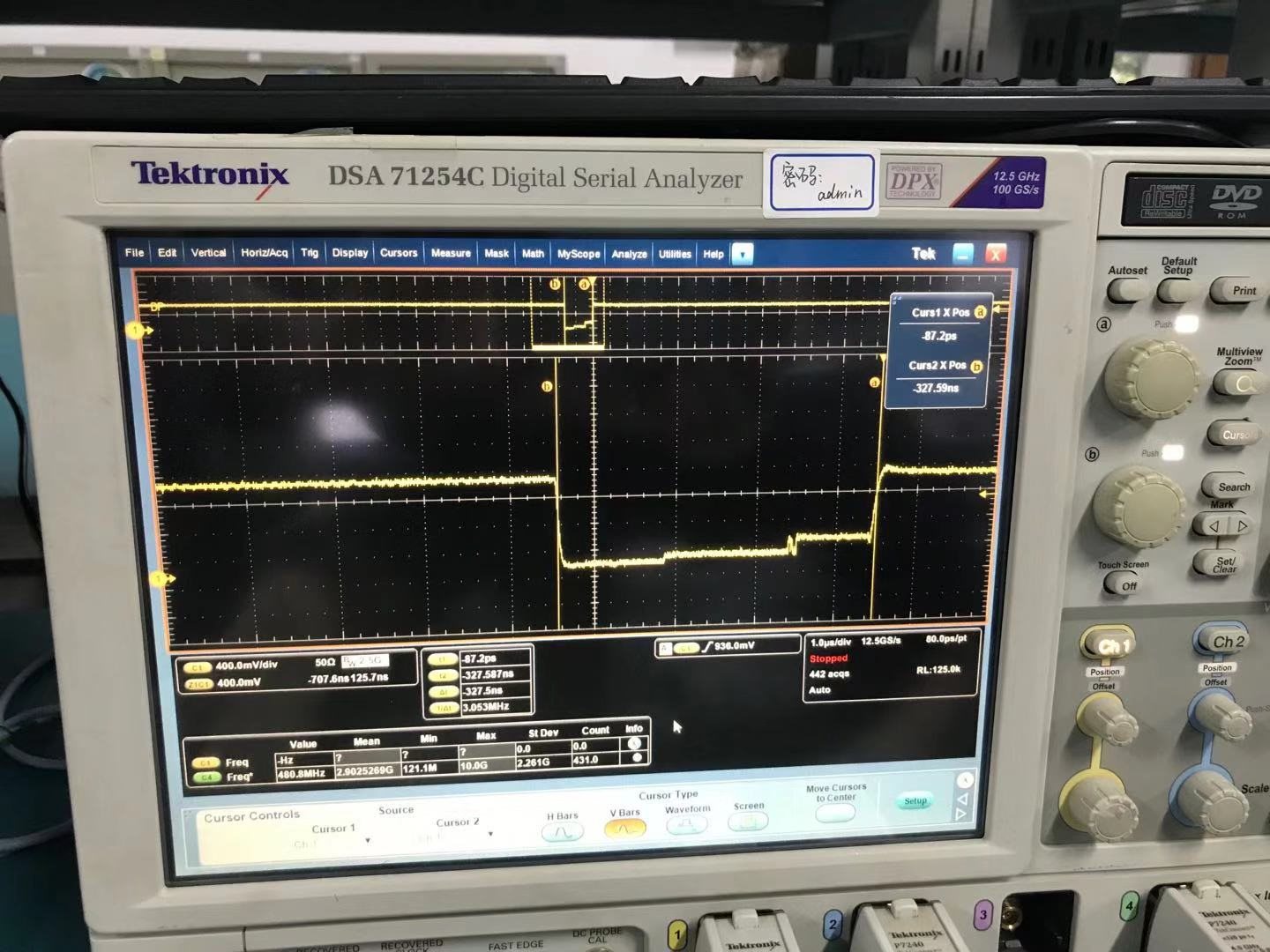

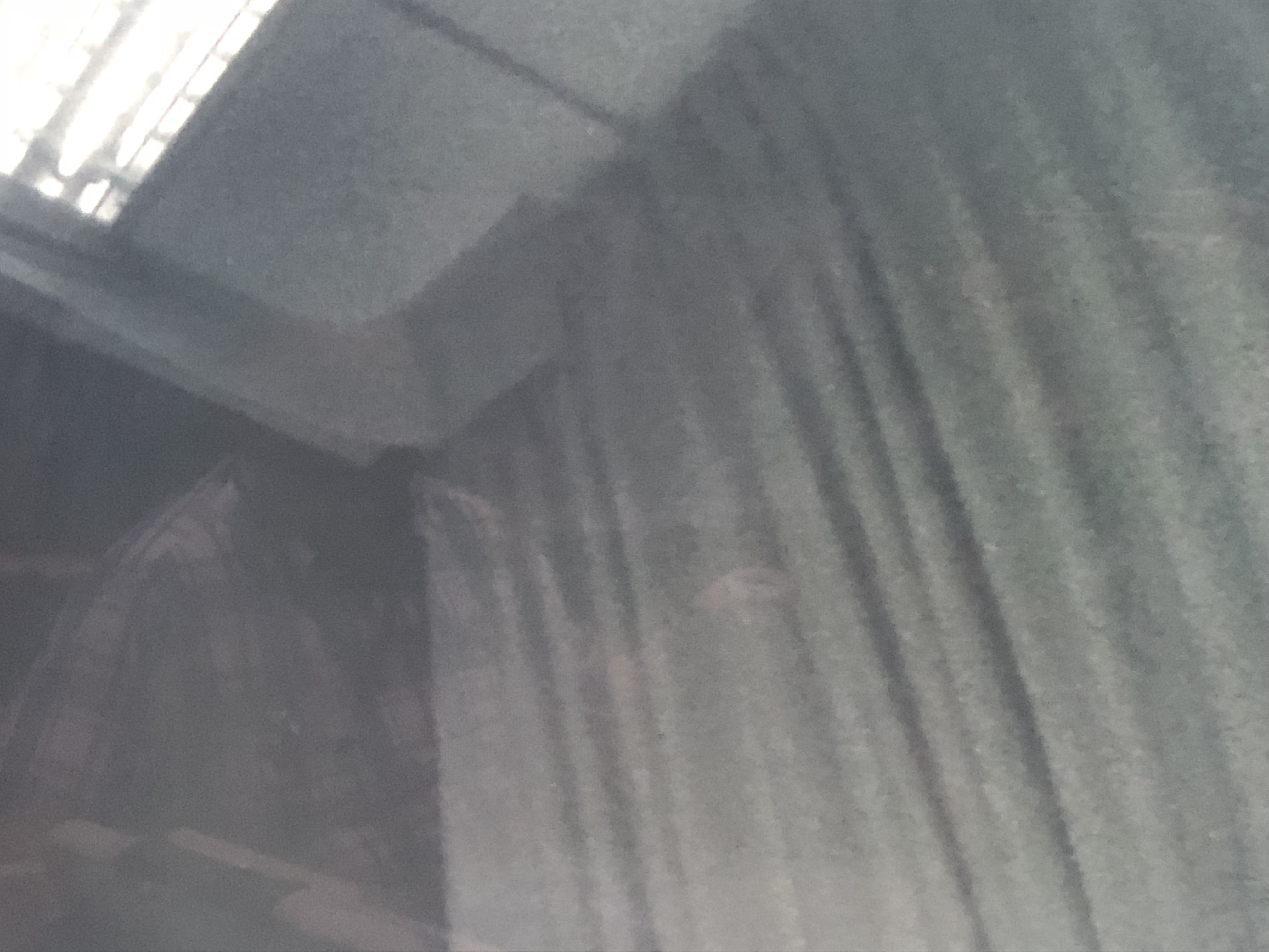

Hi Sir,
Need help to review the setting. There has issue in DS90UB953 connect to DS90UB962.
Current information as below:
DS90UB962 i2c id: 0x60 (8bit)
Use “RX0” Channel
DS90UB962 CSI_output use 0
962 to 953 setting as below:
0x6D=0x78
0x10=0x00
0x4C=0x01
0x58=0x5E
0x32=0x01
0x33=0x01
DS90UB953 is using yuv 8bit mipi 4Lane CMOS sensor
DS90UB953 I2C ID is 0x32(8bit)
Need 962 to 953 mipi 4Lane YUV “initial table”
Kindly help to provide suggestion, thanks.
