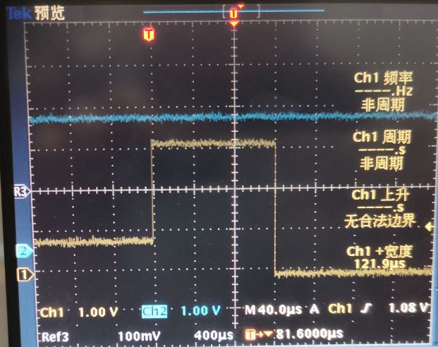

  • Hi:
         today, I measure the RX_ER pin power on voltage , got a strange curve .pls see below , Ch1 is RX_ER signal , Ch2  is VDDIO , the RX_ER  signal first enter the latch voltage about 0.8V for about 200ms when power on , but at last of latch in, there have a about 120us VDDIO voltage(3.3V),I do not know what happened , if final latch voltage is 3.3V , but not 0.8V ,

        sir , any update ? why the RX_ER have about 120us jump to 3.3V , dP83822 still enter RMII mode .

    To enter RGMII mode RX_ER pin must have a voltage that sets it to MODE 2 or 3 to enable RGMII. You are using MODE3.
    Is there any other device on the board driving the RX_ER pin. Is this connected anywhere in the system apart from the voltage divider to set it into mode 3?
    To configure RGMII via registers set RCSR (0x0017) bit 9 to 1. (see "Table 37. 0x0017 RMII and Status Register (RCSR)" in datasheet)
    If your intention is also to set to auto MDIX, please also set PHYCR (0x0019) bit 15 to 1. (see "Table 39. 0x0019 PHY Control Register (PHYCR)" in datasheet)
