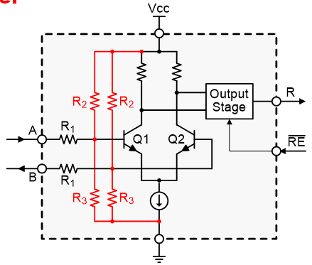

Hi team,
How to analyze following circuit?
(1)This allows the comparator to evaluate the differential voltage between A and B without the need for a connection between the driver ground and receiver ground.
(2)R2 and R3 attenuate the voltages appearing at the A and B terminal, to ensure that the comparator inputs are not saturated.
Why? Could you please explain it using some formula? Thanks
  • Hi Naizeng,
    This circuit both attenuates the input voltage and rebiases them to voltages within the range supported by the comparator. This is useful in supporting a wide input voltage range (the RS-485 standard specifies an operating common mode voltage range extending from -7 V to 12 V). To analyze the circuit, you may want to R2 and R3 to a Thevenin equivalent circuit. The attenuation factor would be R1 / (R1 + R2||R3).

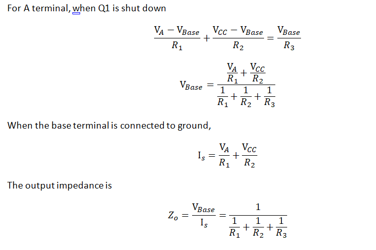

  • Max,
    I get following result using Thevenin equivalent circuit. Do you mean (VbQ1-VbQ2) / (VA-VB)=  R1 / (R1 + R2||R3)? I can't derive the result.
  • Naizeng,

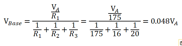

    Your calculation about Vbase is correct. For small signal analysis, you can consider Vcc as 0V (DC source). Therefore Vbase is equal to VA is divided by R1 and (R2||R3). If you replace Vcc by 0V, you can get the same result from your equation. Some typical resistor values are shared in this post.
    e2e.ti.com/.../779327
    The divider ratio is about 1:10. You can run some calculations to see that it can convert -7V to 12V input into around 1.5V to 2.5V range.
    Please let us know if you have more questions.
    Hao
  • Hao,
    According to your explanation,  it can convert -7V to 12V input into around 1.5V to 2.5V range.  So the actual divider ratio is (2.5-1.5)/(12+7)=1:19
    Is there any problem in my calculation?
    And then I calculate Vbase according to the resistance you provided, I get the same divider ratio.
  • Naizeng,
    You're right. The ratio in this example is about 20 (175+(16||20))/(16||20). Please let me know if you have more questions.
