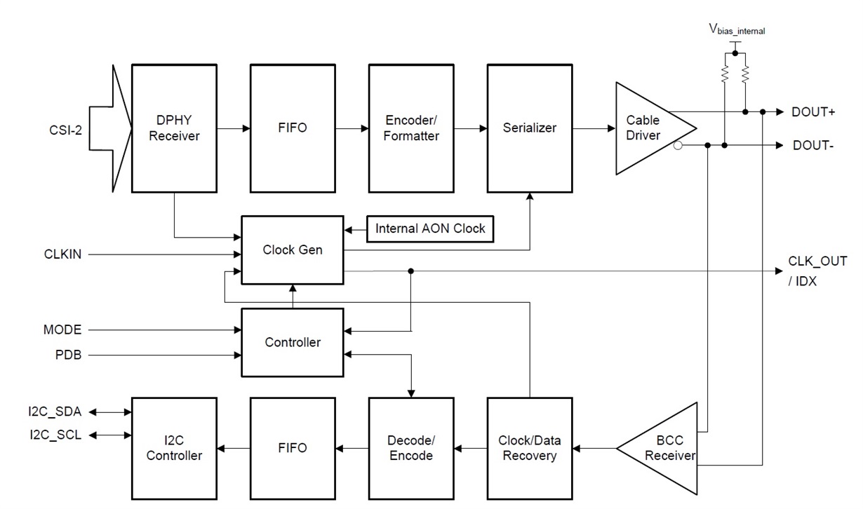

What is the main driver for operating current of the 935?  Is it possible to operate under 100mW average power if the incoming CSI-2 is reduced?  Is it possible to operate under 100mW if fewer lanes of CSI-2 are used?
  • Hi Mark,

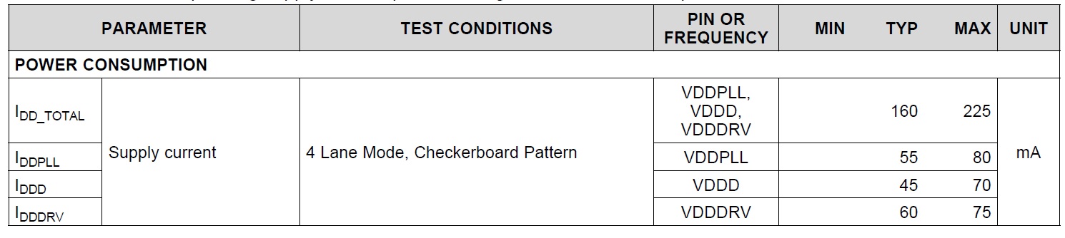

    Please refer to the overall power consumption data of 935 as below.
    But refer to its block diagram, unfortunately we don't have exact testing data of each internal function modules below:
    Just in generally it's difficult as: the overall power consumption is much higher than 100mW, also like use fewer lanes won't affect much of internal function module's power consumption.
