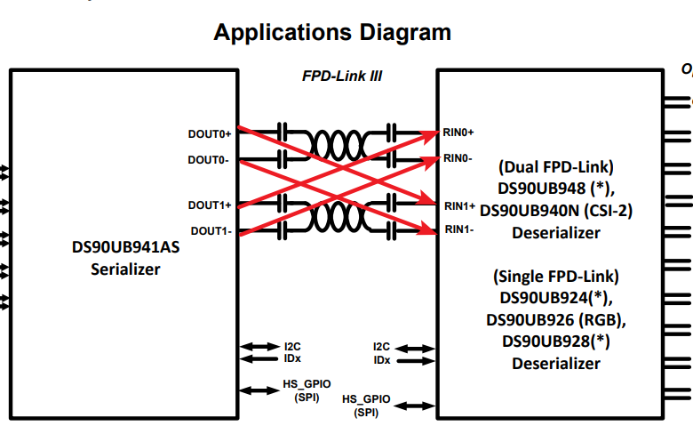

  • Sorry. may be I have mistake on my description
    There are two condiction:
    1) Dout1 to Rin0, Dout0 to Rin1:Can we change it through register configure?
    2) Dout1+ to Rin1-, Dout1- to Rin1+: Does it matter?Can we change it through register configure?
    Thanks!
  • Hi Amelie,
    Thank you for the updated diagram.  The response above is still suitable for case (1), assuming the ports are used independently.  If the ports are used for odd / even processing, you would need to test the system as it is not offered as a feature in the datasheet.  Please use like ports for like ports as shown in the diagram above (without the red arrows).
    For case (2), please refer to the datasheet for respective parts searching for the term 'polarity'.  Some of these devices do offer the ability to change the polarity of some pins, but FPD link RX/TX ports are not listed in the datasheets reviewed.
