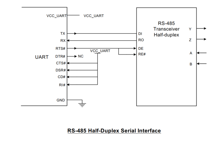

    I use the RTS to control RS485 TX/RX direction, but I find that RTS always low. So I can only send messages, can not receive. Here is the connection between TL16C752D and RS485 Transceiver.
    Can you help me to find why?
    Yafei

  • Hi  Eric
        Here is my schematic ,  the RTS is always low(from TL16C742D) , according to my schematic , the RS485 transceiver will enable TX , so I can not receive data from another side.
    (1)When I disable Auto-RTS , and set MCR[1]=0 , now I can only receive data, but can not send data.
    (2)When I disable Auto-RTS , and set MCR[1]=0, now I can only send data, but can not receive data.
    (3)When I enable Auto-RTS,  the RTS from TL16C752D  is always low  after  opening the uart port when I send or receive data
    I want to know why the RTS can not work normally?

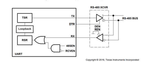

    another question : If I change RTS to DTR , to  control the direction of RS485 TX/RX, as following:
    I can successfully control the direction of RX/TX.  Do you office recommend this way ?
    Yafei
  • Hi Yafei,
    Unfortunately, the first image you posted is not appearing. Please try reposting it if you have questions or concerns regarding the schematic.
    It is good to hear that the system is able to both transmit and receive data. Using RTS as the direction control would serve as a more manual way to select which mode the RS-485 transceiver would be in. It is good that this method proved useful for testing the hardware of the system. However, because this is not the intended use of the pin and it is being used as a GPO, the internal FIFO-based flow control does not operate as it would during typical UART transactions.
    Changing to use DTR as the EN input for the RS-485 would streamline this operation. In RS-485 alternate mode (AFR[2]) the DTR pin is intended to be used as the RS-485 driver EN input. This will cause the pin to be set HIGH when there is data available in THR or TSR so it can be transmitted over RS-485. Once the delay set by DLY[2:0] expires, the pin will go LOW allowing the half-duplex RS-485 driver to act in receiver mode to receive messages from the bus.
