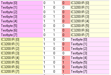

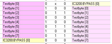

I have also problems with BScan on DP83TC811R-Q1. I have RESET, EN and WAKE all HIGH. The first Shift on Data Register is possible but when I will make 1 Shift on instruction Register I get a Fail. In my opinion, the answer to the expected answer is shifted by one bit.
BG
Falk
