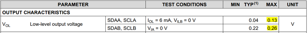

Hi Team,
I am considering to use TI P82B96 device.
According to the data sheet with VCC 0f 3.3V (see below picture) the VIL (TYP) is 0.88V (and can reach even 1V) and I wand to connect it to LVCMOS 1.8V Bisdirectunal FPGA pin
The problem is that the LVCMOS 1.8 VIL Max Voltage is 0.35 x 1.8 = 0.63V which is below VIL of the P82B96 device.
Can you recommend solution/device that will enale me to interface the P82B96 that works with VCC of 3.3V to LVSMOS 1.8 bidirectunal pin
P82B96.docx
Shlomi

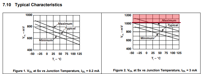

  • Hi Shlomi,
    The diagram you shared looks good. All Vol - Vil combinations are compatible based for typical datasheet specifications and the placement of of pull-up resistors is correct. I will advise that there is possibility for incompatible output voltages from the P82B96 under certain operating conditions; large current sink requirements and cool junction temperature (Iol = 3mA and Tj < 25C). Please check your design with Figure 7.10 on P82B96 datasheet to make sure the system can tolerate these conditions. I would suggest carefully choosing the pull-up resistor values to ensure that this sink current is not required of the device. Let me know if you have questions about this.
    From P82B96 Datasheet:
    TCA9803 Max Vil = 0.99V when Vcc = 3.3V. P82B96 Vol must be below this value (red line above).
    Eric
