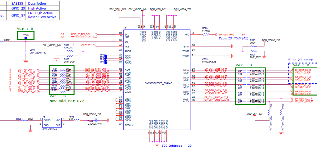

Part Number: SN65DSI86
Other Parts Discussed in Thread: TEST2,
Hi team,
We can't do the compliance test of Pre-Emphasis test items. The detail please refer to the attachment.SA8155 Native DP_lane 0_RBR~HBR2 3.9dB_25.pdf
HW setting :
1. TEST2 pin pull high to 1.8V
SW setting :
CSR Bit Field Definitions : Original is 0x93. Modify to 0x20 = 0b ( 0010 0000 )
program a 1 to bit 0 of offset 0x16 at Page 7 followed by a write of 0
to bit 0 of offset 0x5A at Page 0 before writing either a 0x6 or 0x7
