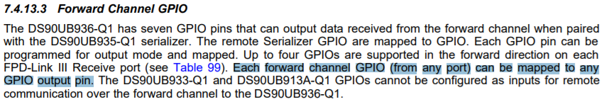

Hi TI,
I wanna confirm that each GPIO pin of DS90UB935 can be mapped to any GPIO of DS90UB936? eample: DS90UB935 GPIO[0] --> DS90UB936 GPIO[6]
BR

Hi TI,
BR
