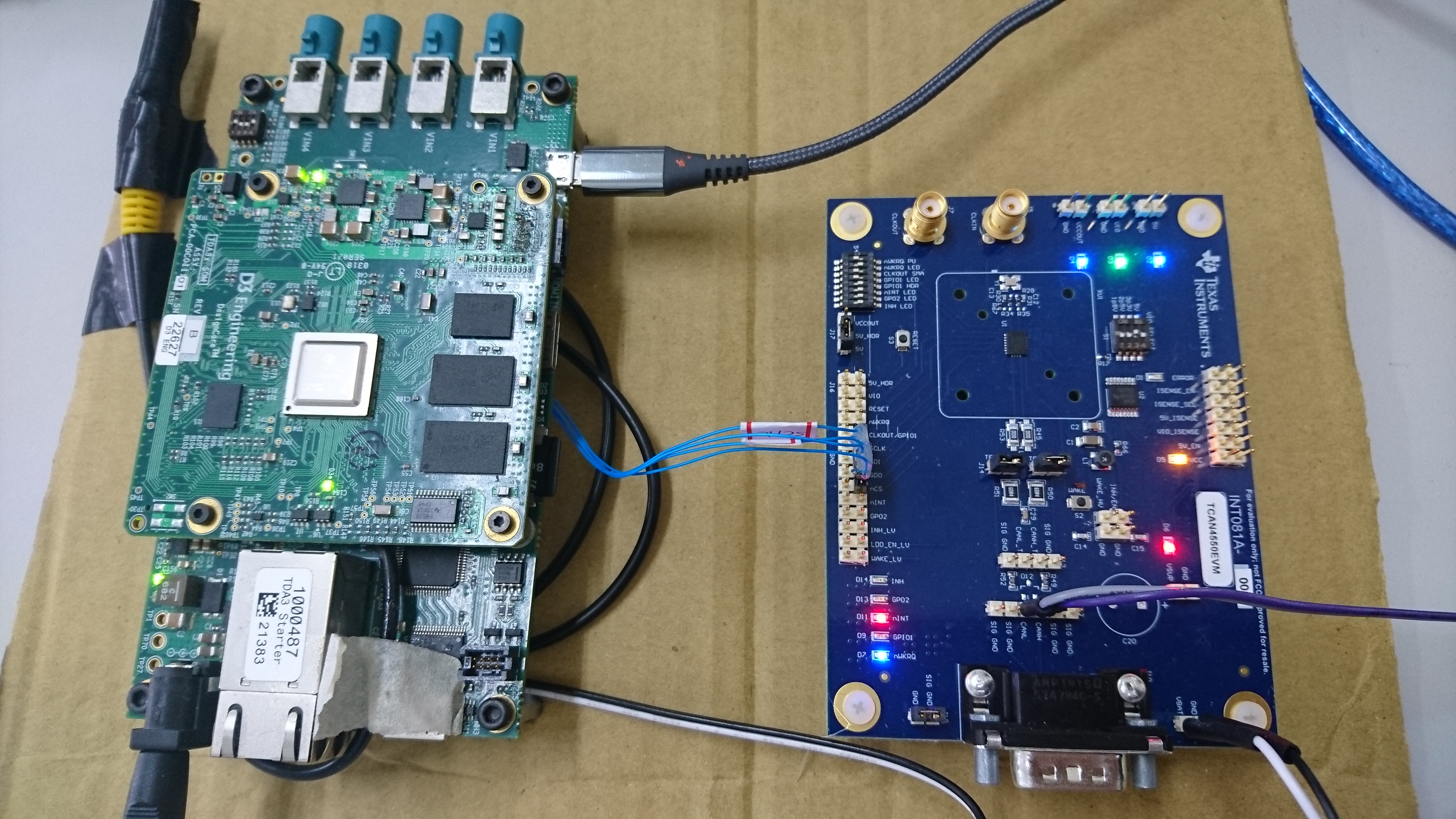

I have used vsdk3.7 and TI provided functions(in utils_mcspi.c) to do SPI communication test.
I have read TCAN4550 datasheet, TCAN45xx software user's  guide, and followed SPI Read or Write format to send a message to TCAN4550EVM.
However, D3-TDA3xx-rvp seems can't get the right response from TCAN4550EVM.
Please tell me what messages I should send/receive to prove SPI communication is successful.
My code shows below.
Could you help me check hardware configuration and fix related software problems?Thank you.

  • Hello Ethan,
    I support the TCAN4550 device and will help you the best I can.  I am not currently familiar with the code that was provided to you from the D3-TDA3xx-rvp team so if I am unable to help you we may need to get them involved.
    The photo of your setup looks correct.  We basically need a VSUP voltage greater than 6V at the device pin.  You have supplied power to the VBAT header as expected which has a reverse polarity protection diode that will make the VSUP voltage a diode's drop lower than the VBAT supplied voltage.  Therefore you will need to make sure your supply is at least 7V.  Since the other power rail LEDs are on, I believe you have this correct.
    Then you will need your SPI wires connected to your processor board.  It appears you have wires connected to the correct SPI header pins.  I would also ask that you make sure you have connected the GND between the processor board and the TCAN4550 EVM.  Without a common GND connection, SPI communication will have no return path for the current and therefore fail.  I can't tell if the GND pin of the VBAT header on the supply is common to the Processor board, and even if it is, I might recommend using another GND pin on the same Digital IO Header on the TCAN4550 closer to the SPI pins to make a less inductive return current path between the two boards and improve the signal integrity of the SPI communication if it has become noisy.
    Later on once communication is established, connecting the interrupt pins such as nINT, GPIO1, and GPO2 could be connected as well, but this won't impact the current issue.
    I will note one additional device/hardware related issue that sometimes comes up during the early stages of firmware development.  The TCAN4550 has a failsafe feature that will cause the device to enter Sleep Mode after 4 minutes of inactivity.  When the device powers up, a 4 minute timer starts and the device needs to be configured into Normal Mode, or have the Power On Flag (PWRON) cleared.  This is described in the datasheet.  If you are unaware of this, it is common to have long pauses between your tests while you check code, read datasheets, etc. and when you come back to the device, it has entered Sleep Mode and will be unresponsive.  You can press the WAKE pushbutton, the Reset pushbutton, power cycle the device, or provide a Wake Up Pattern (WUP) on the CAN bus to wake it up so that it enters Standby mode again.  You can disable this feature by setting the SWE bit to 1 in the Configuration register, but this bit will have to be set following every initial power up.  In your photo, the LEDs are on so the device is not in Sleep Mode, but if you have not disabled this bit, the SPI communication will fail if the device is in Sleep Mode.  Once we get SPI communication working, you should be aware of this moving forward and add it to your configuration routine.

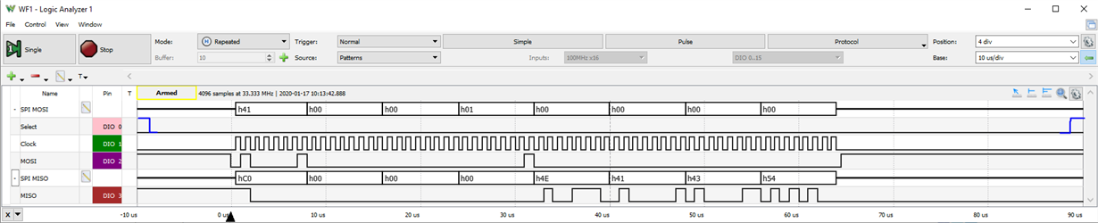

  • Hi Ethan,

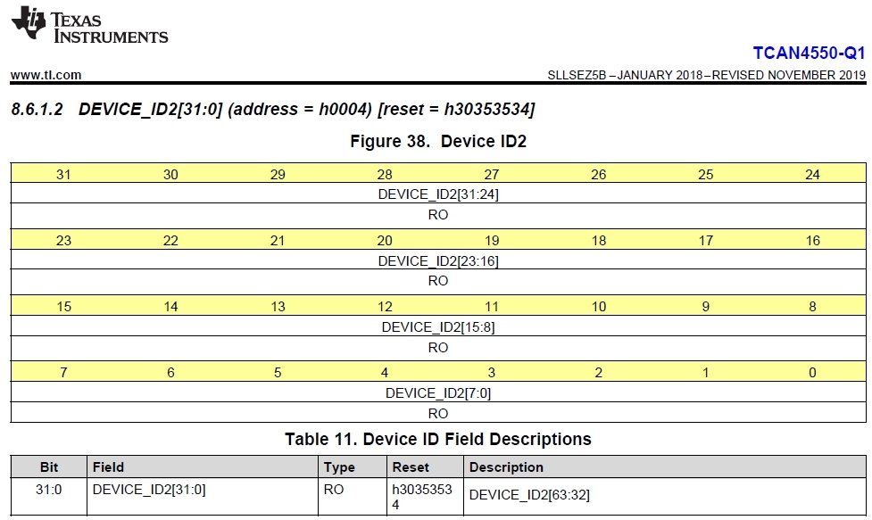

    When reading register 0x0004, the device will return 0x30, 0x35, 0x35, 0x34 as you suggest.  The read data is the last 4 bytes of Write function and therefore you need to be able to both write data on your MOSI pin and capture data on the MISO simultaneously.  When using the 0x41 "read" op code, the TX data bytes are of don't care value since you really just need to provide the clock cycles in order for the TCAN4550 to clock out the register data associated with the address you provided in the 2 bytes following the 0x41 op code.  The first byte returned on the MISO line simultaneously with the op code is the TCAN4550's Global Status Register that has the interrupt flags.  This is so the processor can monitor for SPI and other errors on every SPI transaction without specifically polling the status register.
    When using the 0x61 write op code, the last 4 data bytes are written to the register address provided immediately following the op code.  All bytes of the MISO except the first global status register are of don't care and can be ignored.

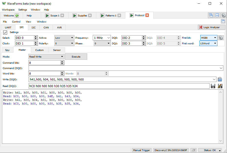

    Here are some plots from a basic SPI protocol tool and Logic Analyzer for your reference.This tool is wired over to the EVM just as you are trying to do with your processor board.
    This first image is the read/write log from the protocol tool.  I read both registers 0x0000 and 0x0004.

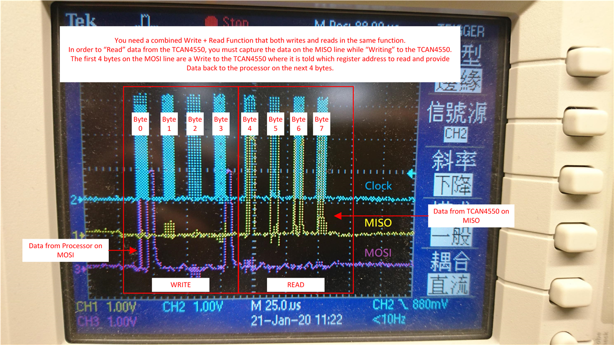

    This next image is the Logic Analyzer plot when reading register 0x0000. Just as a note, the Select line transitions were off screen with the required zoom settings needed to see the hex decoding values of the bytes.  So I just drew the falling and rising edges into the waveform shown in blue since they are required at the start and end of each SPI transaction.
    This next image is the Logic Analyzer plot of reading register 0x0004.  Once again I drew in the Select transitions.
    If you have any ability to monitor the SPI signals using a scope and logic analyzer, it would be good to know if there is any signs of activity on the TCAN4550 SDO (MISO) pin.  And is this a clear representation of what to expect from a TCAN4550 SPI Read?
    Jonathan
  • Hi Jonathan,

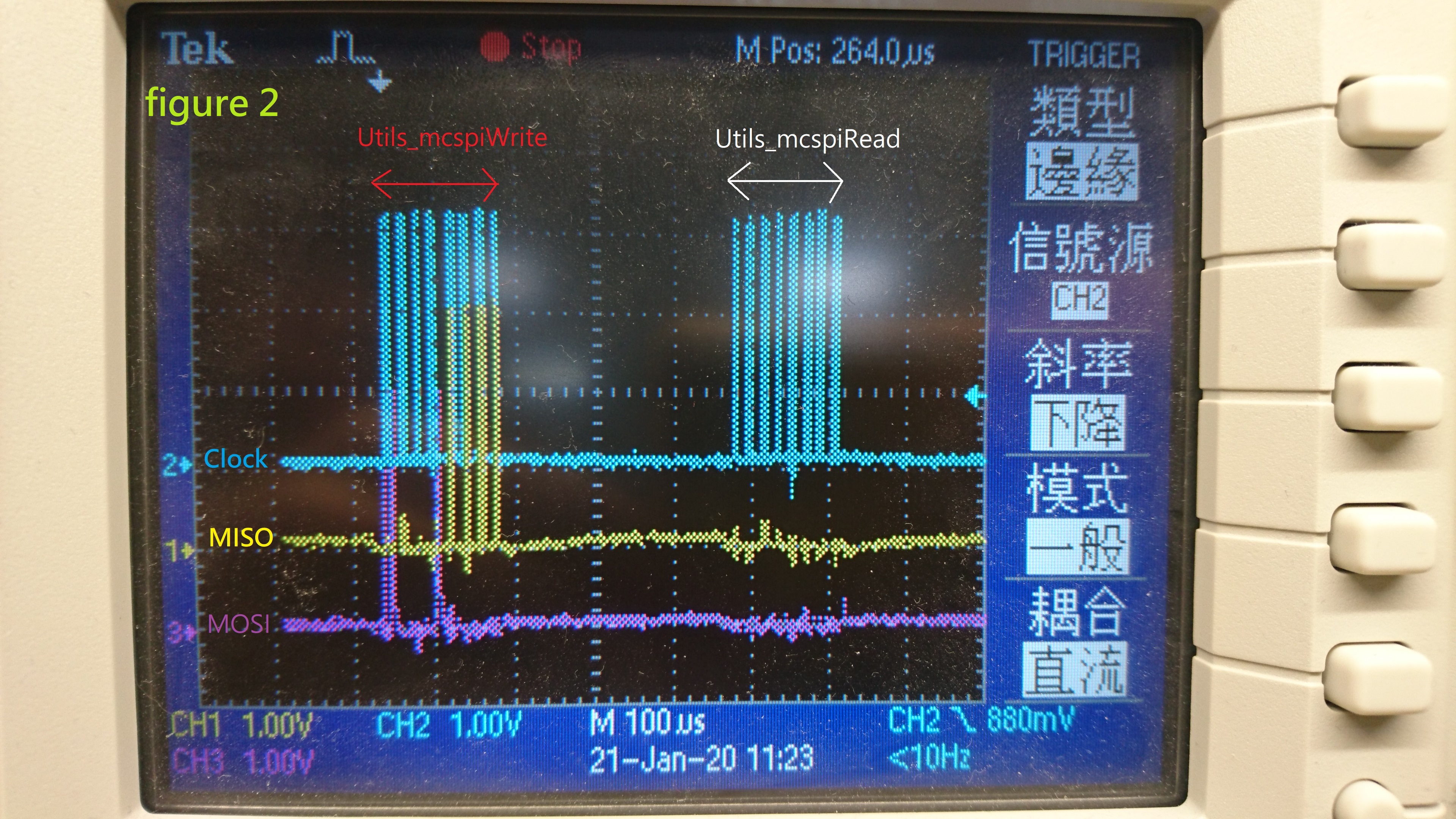

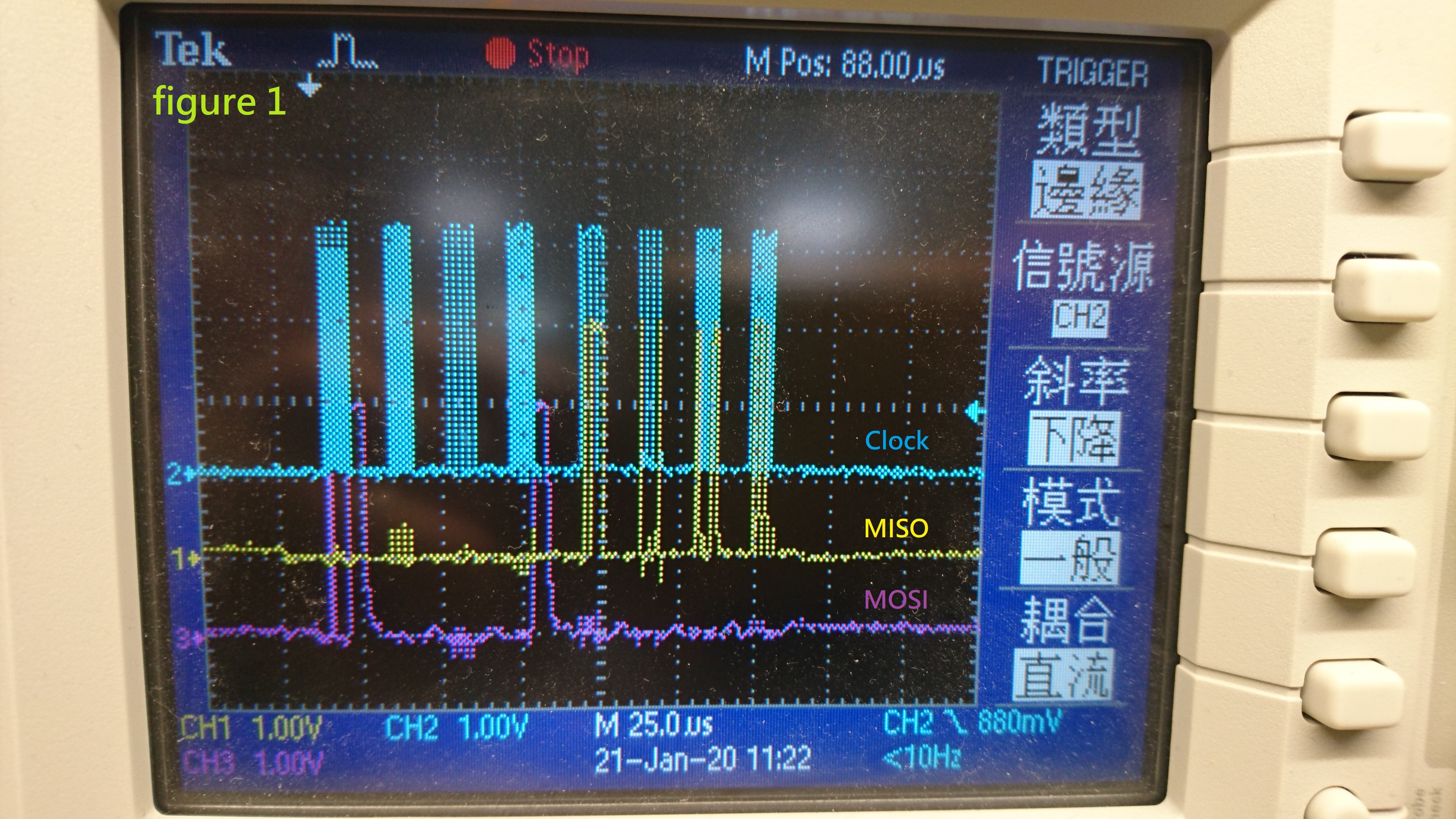

    My source code and test results show below.
    According to figure 2, while calling "Utils_mcspiWrite()", TCAN4550EVM seems to return messages simultaneously.
    So, the following "Utils_mcspiRead()" can't get return messages successfully. What is the right way to get return on D3-TDA3xx-rvp?
    Could you help analyse this problem and check software process, initialization and settings(in utils_mcspi.c)?

    I now see what you are facing.  Thanks for the scope plots and code file.
    From the scope plots, I see that you are in fact communicating with the TCAN4550.  The data on the yellow MISO line during your "Utils_mcspiWrite" function is the response from the TCAN4550.  There is no response from the TCAN4550 during your "Utils_mcspiRead" function because you are not writing the "0x41, 0x00, 0x00, 0x01" bytes to it on the MOSI line for the first 4 bytes.  I don't know what your "Select" line is doing between the the Write and Read functions, but I am assuming that is toggling back High after the Write, and then toggles back Low before the Read.  Unfortunately it is not possible to communicate with the TCAN4550 using this separate Write and Read functions.
    I've highlighted the bytes that are important as a Write, and the bytes that are important for a read during this process and to also show you that you are in fact getting data from the TCAN4550.
    You need a combined Write and Read function where you are both writing data on the MOSI line and capturing data simultaneously on the MISO line.  You can either create a new function for this, or try to modify the existing Write and Read functions.  I am not familiar with this particular processor, SDK, or source code files and if you need help writing these functions I may need to forward this thread into the Processor Forum where you can get some more code specific support.
    But here are some suggestions on how to modify the code to work from a general perspective.
    1.) Create a new Write_Read function that simultaneously outputs the TX buffer on the MOSI pin while capturing the data on the MISO pin.  This is my preferred method and how we do it in other processors.  It is important that the SPI Chip Select line transitions Low at the beginning of the packet and then High again at the end of the packet in order for the TCAN4550 to not discard the transaction and set the SPI Error flag.
    2.) Modify the Write function to capture the data on the MISO pin and return this buffer.  It is obvious the Write function is working properly and the TCAN4550 is responding.  We simply need to capture the data on the MISO line.  Then in your application code, to "write" to a register, you need to set byte0 to 0x61, and the last 4 bytes will hold the register data.  When writing to a register using op code 0x61, the rx buffer storing the MISO data is a don't care and can be ignored.  To "read" a register, you need to set byte0 to 0x41, and the last 4 bytes are don't care values or usually 0x00.
    3.) Modify the Read function to write data on the MOSI line just like is done during the Write function.  The end result would be the same as modifying the Write function, but perhaps this is a better option because when you can then leave the write function unchanged because it is working fine as it is.
    4.) Modify how the SPI Chip Select pin is toggled with regard to the two functions and make a separate function that only toggles this line.  Then you can create a function or combination of the Write function, and Read function using 4 bytes for the write (bytes 0-3) and then 4 bytes for the read (bytes 4-7).  This should work as long as you the Select line remains low during between the read and write functions and only transitions high again at the end of the read function.
    Outside of providing you with the actual lines of modified code, does this make the situation clear about what the problem is and the approach that needs to be taken to correct it?
    Jonathan

    Sorry for late reply. I was on vacation last week.
    I have SPI communication problems between D3-TDA3xx-rvp and TCAN4550EVM.
    I have provided test result on Jan 21, 2020. e2e.ti.com/.../3233981
    I used TI provided "Utils_mcspiWrite()" and "Utils_mcspiRead" functions(in utils_mcspi.c), and the procedure shows below.
    According to scope plot, while calling "Utils_mcspiWrite()", the write function seems working.
    However, TCAN4550EVM seems to return messages simultaneously so that the following "Utils_mcspiRead()" can't get response successfully.
    I have no idea how to store response data on D3-TDA3xx-rvp and how to modify code(VisionSDK 03.07.00).
    Could you provide sample code or help me modify VisionSDK 03.07.00 step by step, please?
