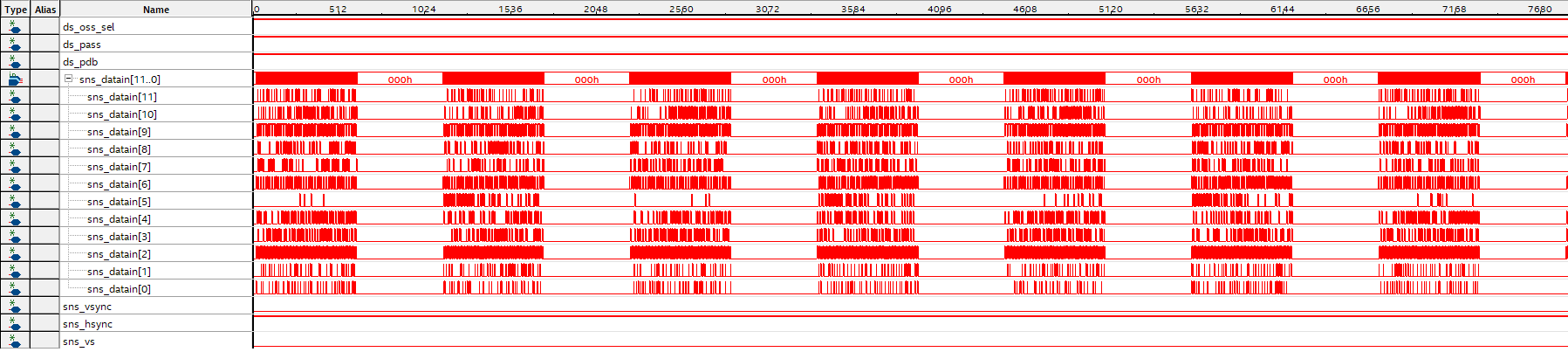

  • Update:
    I resolved the issue of the aforementioned post, but HSYNC and VSYNC signals are still no where to be found.
  • Here is a screen capture of the waveforms on the various 934 deserializer pins while the system is running.  Datain = ROUT. Notice how HSYNC stays high, VSYNC stays low. They have yet to ever change.

    In 12 bit mode, there is still no movement on the HSYNC and VSYNC pins. Here is what the data looks like :
