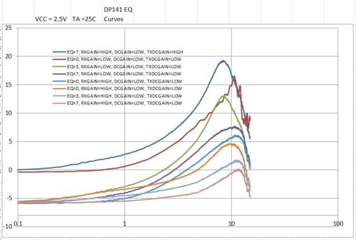

Part Number: SN65DP141
Could you please provide to me the EQ gain curve for SN65DP141?(both cable and trace mode )

Jeong
Please give me a day to see if I can find the data.
