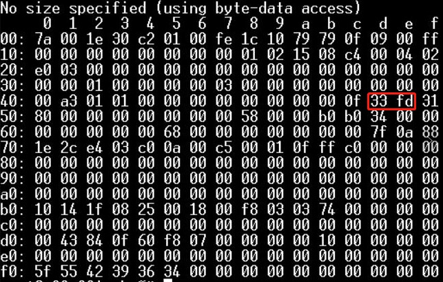

  • Hi Steven,
    As mentioned earlier, we set one camera related TI964 registers and display correct image to our ECU system.
    After we want to set the registers of 4 channels cameras, but is still does not work.
    Then, we back to check the register of one camera(TI913A) shown as following:
    It seem 0x4D~0x4E registers are abnormal.
    Could you help us to review and resolve this issue?
    Ja
    Can I have your feedback for this?
    Ja
  • Ja,
    in your dumping registers, reg. 0x4C is set as 0x0f, it means you are reading channel 0 register, registers 0x4D/0x4E indicate link error but register 0x55/56 don't have bit error. I would double check with you, if you read it twice as these registers can latch the starting-up status which could have error.
    for reg. 0x73/0x74, it is  0x03c0, it means the line count is 960. reg. 0x75/76 is 0x0a00, it means the line length is 1280. so in your case, ub964 can receive the correct video with 1280x960 resolution.
    best regards,
    Steven

    I had given your example in my last reply, that is in our 964evm user guide, page22. You can refer to the script setting.
    In your case, the forwarding is sync. mode, please secure that the issued camera module also can support the sync. mode, here, it sounds the camera module doesn't support the sync. mode (you need check the reg. 0x21).
    as mentioned, if only one camera is used, it is synchronized by itself, so the 1pcs Sony camera should work well. but for the 4 channels, if Sonys camera is not designed as sync. mode (it is dependent on your camera vendor), then ub964 can't accept it well, and the buffer would be overflowed.
    also, as mentioned, when you read the registers, you should select the port / channel in reg. 0x4c, but it sounds you always make a mistake when set reg. 0x4c before you dump the ub964's register.
    Steven
