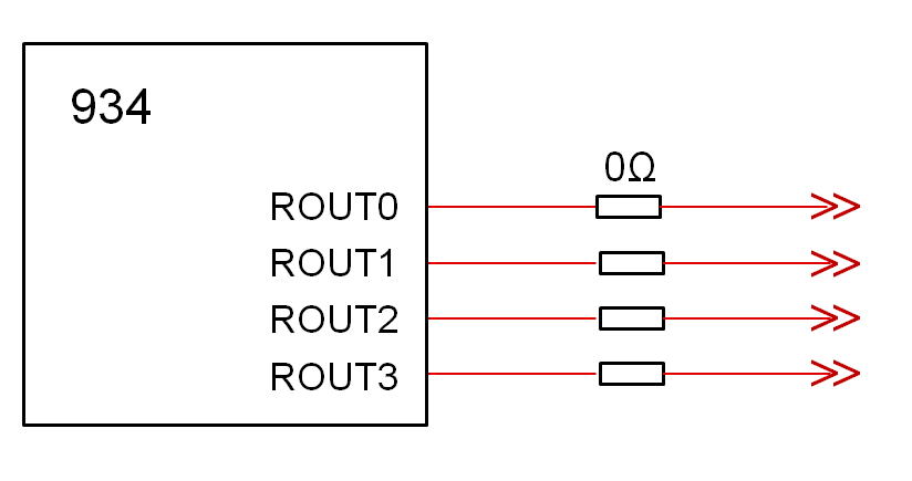

3. Can customer add 0ohm resistor at the ROUT signal trace as below? Will it bring big impact on the signal quality? If the impact is not too much,  customer prefer to reserve these 0 ohm resistors on the PCB.

    For questions 1 and 2 it is recommended to use an external pulldown resistor to connect directly to GND in order to ensure the best EMI immunity vs. leaving the pins floating. For the 3rd question, it is possible to add the 0 ohm resistors but I would recommend using the smallest case size possible in order to ensure the trace impedance has minimal impact going through these components.
