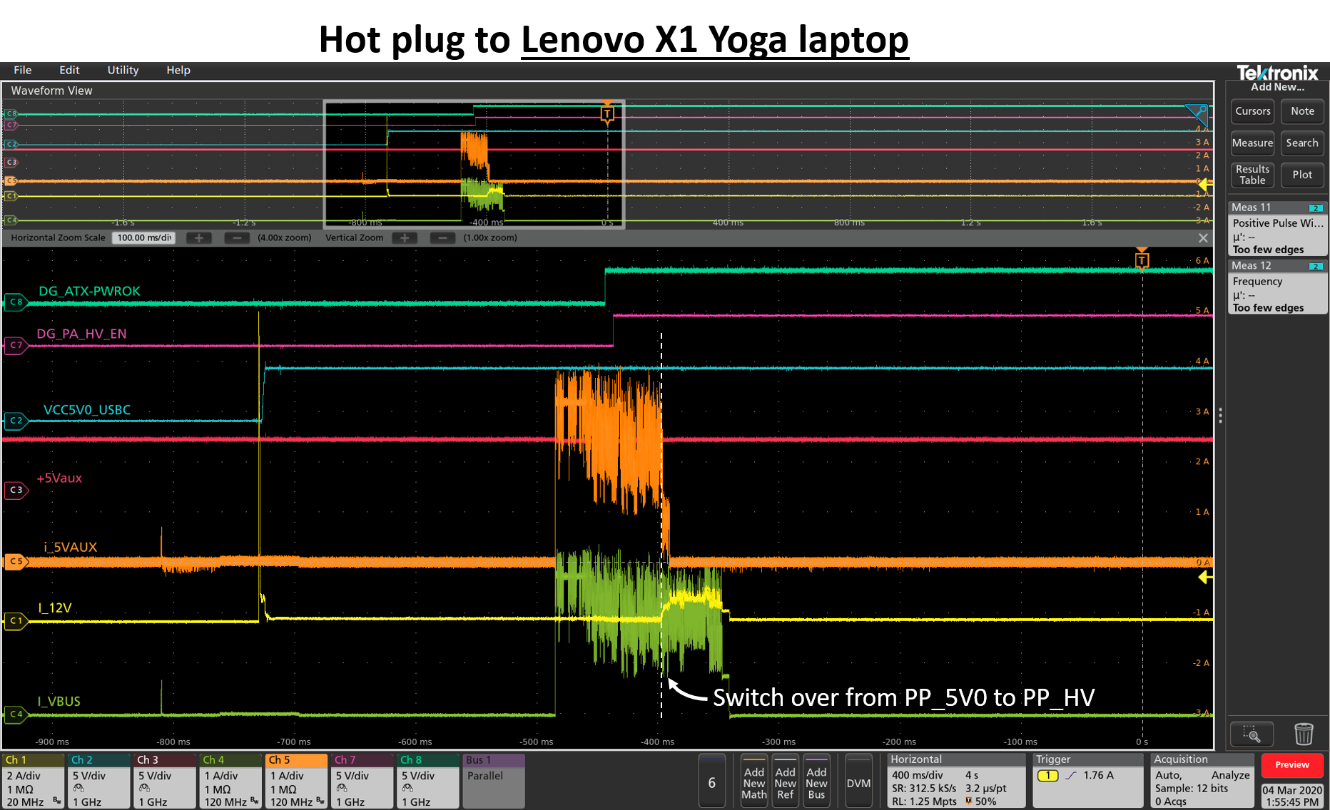

We are currently observing an outlier behaviour when a Lenovo X1 Yoga (3rd gen) is hot-plugged into our product when running from AUX power.
When a Lenovo X1 Yoga Laptop is hot-plugged to our product, there is a huge current pulse (3A) being drawn from the Lenovo laptop from AUX power. This behavior is different compare to what we see from a hot plug to MacBook or Dell Latitude Laptop. Additionally, we’re expecting that the TI TPS65983B should switch to the main power rails (since we’re using the ATX firmware) so that the current would be drawn from the main power instead of drawing from the AUX power rail.
 Below are the probe point & scope shot that we have with Lenovo.
The Lenovo start to draw current before DG_ATX_PWROK asserted. Hence, VBUS is drawing current from PP_5V0 (Aux power) & only switch over to PP_HV (main power) after DG_ATX_PWROK assert.

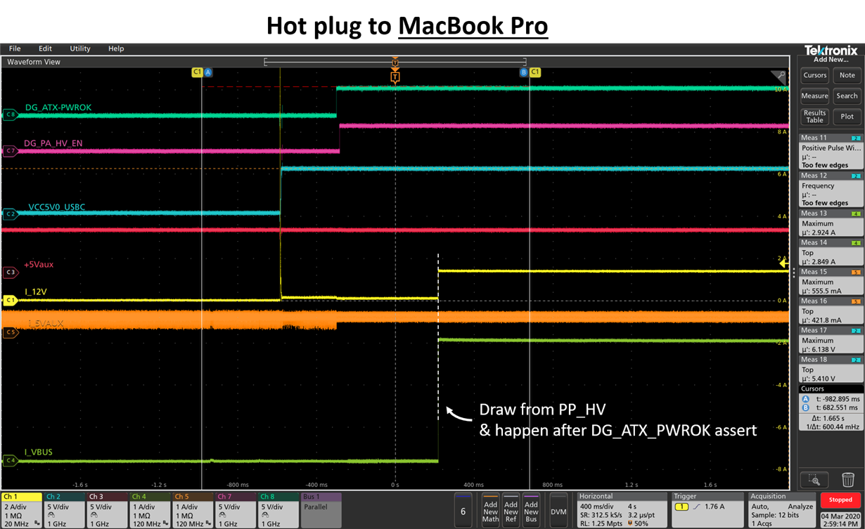

Compare to hotplugging to a Macbook, PD happens after DG_ATX_PWROK. Hence, VBUS is drawing current from the main voltage. (which is correct behaviour)

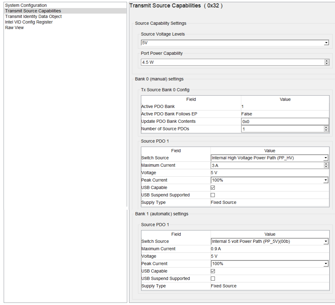

  • Hi Scott,
    Yes, it is configured to only support 5V@0.9A at PP_5V0 & 5V@3A at PP_HV.  Is the image below contain the info you want?
    Alice Ng

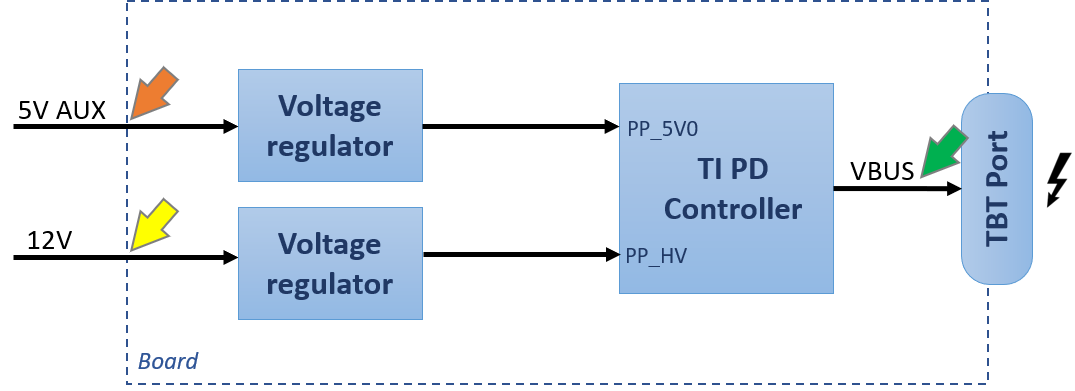

    A few questions about the scope plots that I want to double check for my understanding:
    -Is VCC5V0_USBC the power supply (voltage) input to the TPS6598B PP_5V0 path?
    -Is I_12V the 5V 3A supply (current) input to the TPS65983B PP_HV path?
    -Is I_5Aux the 5V 900mA supply (current) input to the TPS65983B PP_5V0 path?
    -Do you have a plot of V_Vbus?
    Scott
  • Hi Scott,
    No, VCC5V0_USBC is the voltage input to PP_HV.  +5Vaux (red line) is the voltage input to PP_5V0.
    Yes. Below scope shot is captured during hotplug to the Lenovo laptop. Please refer to the dark blue line.
    Alice Ng
